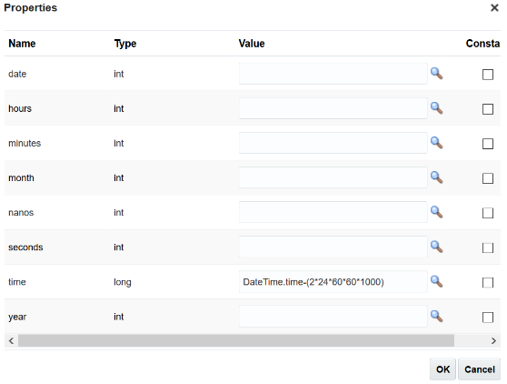

  4. Calculate the amount of time to delay shipment.
    • Click Edit Properties.
    • In the Properties dialog, in the Time row, click Value.
    • In the Condition Browser, expand DateTime, then click Time.
      Note that the Condition Browser adds a value of DateTime.time to attribute Expression.
    • In the Expression attribute, append -(2*24*60*60*1000) to the end of DateTime.time.

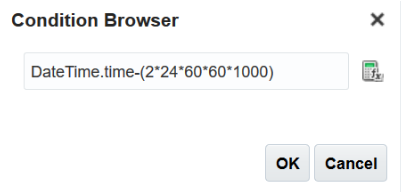

      You can use the getAdjustedDate instead function of DateTime.time.
    • Make sure the Expression attribute includes DateTime.time-(2*24*60*60*1000), then click OK.
      For example:
      condition browser with DateTime.time-(2*24*60*60*1000)
    • Make sure the Properties dialog includes the value in the time property.
      values in Properties dialog

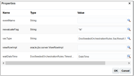

  5. Pause the orchestration process.
    You will set these properties.
    ( reevaluateFlag:"N", sacType:DooSeededOrchestrationRules.SacResult.SAC_TYPE_TIMER, waitDateTime:DateTime )
    • Click Add Action > Assert New.
    • Click Select a Target > DooSeededOrchestrationRules.SacResult.
    • In the Properties dialog, in the reevaluateFlag row, in the Value attribute, enter "N". You must include the double quotation marks.
    • In the sacType row, click Value.
    • In the Condition Browser dialog, expand DooSeededOrchestrationRules > SacResult, click SAC_TYPE_TIMER, then click .
      A pause type of TIMER causes the orchestration process to pause until time elapses.
    • In the Properties dialog, in the waitDateTime row, click Value.
    • In the Condition Browser, click DateTime, then click OK.
    • Make sure the Properties dialog contains these values.
      dialog with the required values
