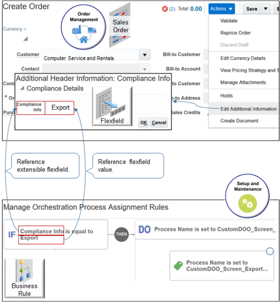

You do a needs analysis and determine to create the Trade Compliance Details extensible flexfield and add it to the order header so the Order Entry Specialist can enter the value Export to indicate whether the sales order is an export.
You will create an assignment rule that references the extensible flexfield.
You will create an assignment rule.
If the Trade Compliance Details extensible flexfield contains the value Export, then assign the fulfillment line to the Screen_Exports_for_Trade_Compliance orchestration process.

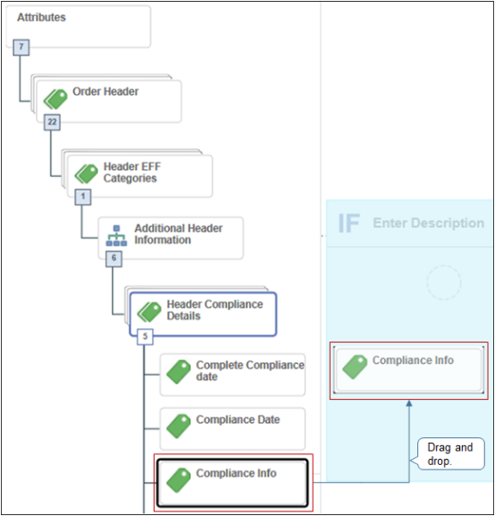

Create the If statement.
Click in the If area to expand it.
On the Attributes tab, expand Order Header > Header EFF Categories > Additional Header Information > Header Compliance Details.
Click
Compliance Info, drag it, then drop it into the IF area.
In the Create Condition dialog, set the operator to
Is Equal To. -
Enter
Export, then click OK.
