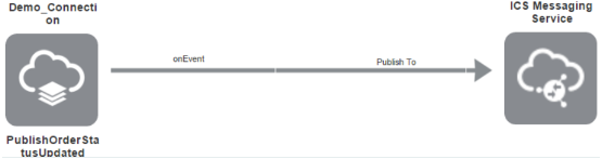

Here's the integration you create.
Create an integration that monitors business events.

Drag and drop Connection_for_Order_Status_Update from the search results onto the Drag and Drop a Trigger area.

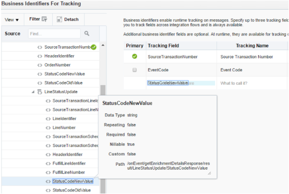

For this example, on the Business Identifiers for Tracking page, in the Source tree, under the result branch, click Load More.
Here are the business identifiers you will track.
Drag and drop SourceTransactionNumber from the hierarchy tree to the first row of the Tracking Field column.
Drag and drop Event from the hierarchy tree to the second row of the Tracking Field column.
In the result branch, expand LineStatusUpdate, then click Load More.
Drag and drop StatusCodeNewValue from the hierarchy tree to the third row of the Tracking Field column.
Click Done.
On the page that displays, click Save > Exit Integration.

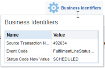

On the page that displays, click Business Identifiers, then verify that the tracking details you set up for tracking earlier displays.
Here are the details you set up in this example.
SourceTransactionNumber. Identifies the order number.
Event. Identifies the business event that gets triggered, which is FulfillmentLineStatusUpdate.
StatusCodeNewValue. Identifies the new status value of the fulfillment line, which is Scheduled.
For example:
