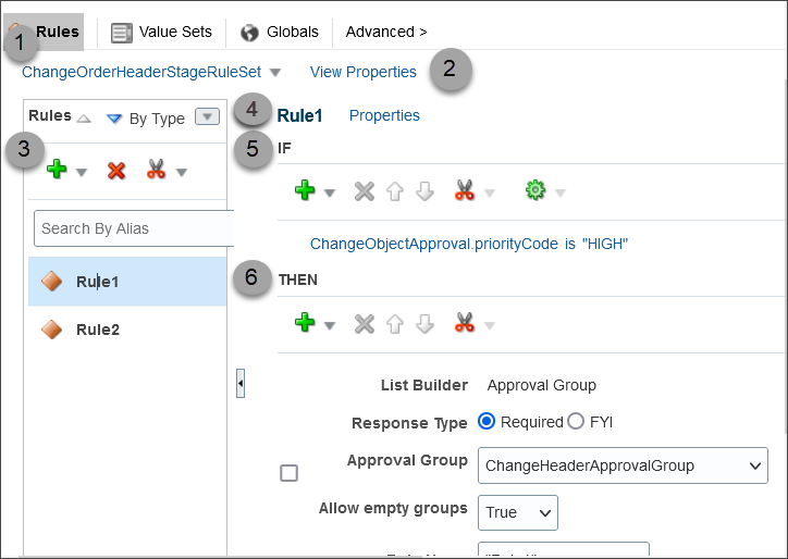

Here's a screenshot to help you understand what you see in the Rules subtab on the Assignees tab:
What you see in the Rules subtab on the Assignees tab
Callout Number
What It Is
1
The rule set drop-down list. Note that only ChangeOrderHeaderStageRuleSet is supported for change orders.
2
The View Properties link that allows you to configure the effective date. It's a good idea to leave the effective date set to Always.
3
The Rules pane that lists the rules within the ChangeOrderHeaderStageRuleSet and includes a toolbar for adding or deleting rules.
4
The name of the rule. Can be modified by clicking the Properties link that's next to the rule.
5 The If section of the rule, where the conditions are defined and there’s a toolbar for working on those conditions.
6 The Then section of the rule, which defines what happens when the conditions are met. There’s also a toolbar specific to this section.

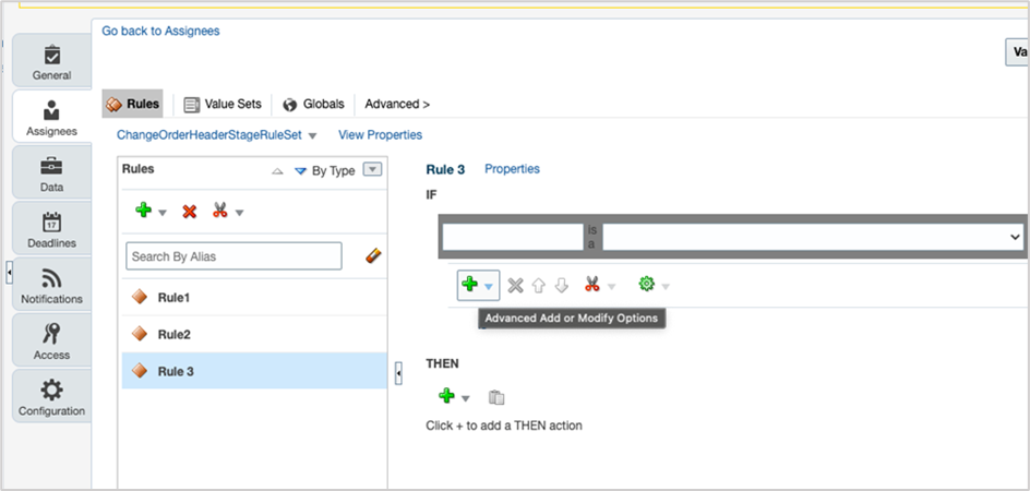

Configure the If Section in Rules
In the If section of the rule, define conditions for the rule. Each line in this section is called a test.
  1. For existing conditions, select the rule that you want to edit. To add a new rule, click the Advanced Add or Modify Options icon and select simple test.Advanced Add or Modify Options
  2. Click the Left Value icon to select an attribute in the Condition Browser dialog box. Click OK.
  3. Select an operator. For example: is.
  4. Click the Right Value icon to select something from the Condition Browser dialog box, or enter a value in the corresponding field. Click OK.
  5. If you’re not working on the last line, you can click the and or or link at the end of the line to toggle between the two.
