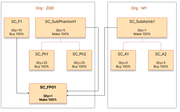

Organization ZQD is manufacturing the item SC_FP01. To manufacture this item, you need various other items. The items, their sourcing rules, and quantities are listed in this table:
| Item | Organization | Sourcing Rule | Source Organization | Allocation | Quantity |
| SC_FP01 | ZQD | Make | N/A | 100% | 1 |
| SC_F1 | ZQD | Buy | N/A | 100% | 10 |
| SC_SubPhantom1 | ZQD | Make | N/A | 100% | 5 |
| SC_Ph1 | ZQD | Buy | N/A | 100% | 25 |
| SC_Ph2 | ZQD | Buy | N/A | 100% | 25 |
| SC_SubAsmb1 | ZQD | Transfer | M1 | 100% | 1 |
The item SC_SubAsmb1 in the above table is made in the organization M1. The corresponding sourcing rules are listed in this table:
| SC_SubAsmb1 | M1 | Make | N/A | 100% | 1 |
| SC_A1 | M1 | Buy | N/A | 100% | 5 |
| SC_A2 | M1 | Buy | N/A | 100% | 5 |
As you can gather from the tables, the organization ZQD requires the items listed here to manufacture the finished item SC_FP01:
SC_F1 – ZQD buys this item and a standard or buy cost must be defined for this item.
SC_SubPhantom1 – ZQD makes this item and needs these items:
SC_Ph1 – ZQD buys this item and a standard or buy cost must be defined for this item.
SC_Ph2 – ZQD buys this item and a standard or buy cost must be defined for this item.
SC_SubAsmb1 – ZQD sources this from M1, which manufactures it with these items:
SC_A1 – M1 buys this item and a standard or buy cost must be defined for this item.
SC_A2 – M1 buys this item and a standard or buy cost must be defined for this item.

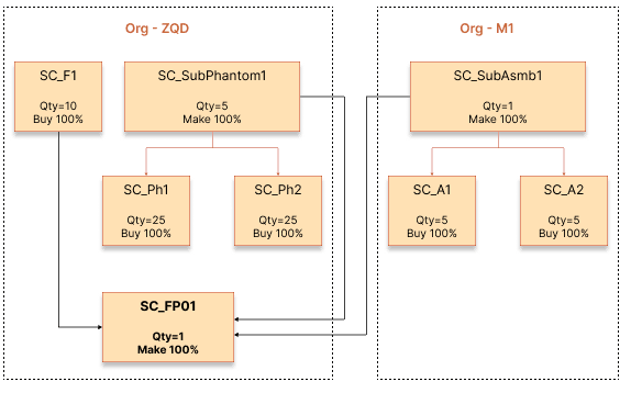

Apart from these materials, you also require various other resources to manufacture this item. Here's an image illustrating the overall manufacturing flow for the finished item SC_FP01.

When you view the rolled up cost for the product, you'll notice that the phantom subassembly isn't shown directly, instead the phantom is expanded to show its components as if they're going into the higher-level assembly.
