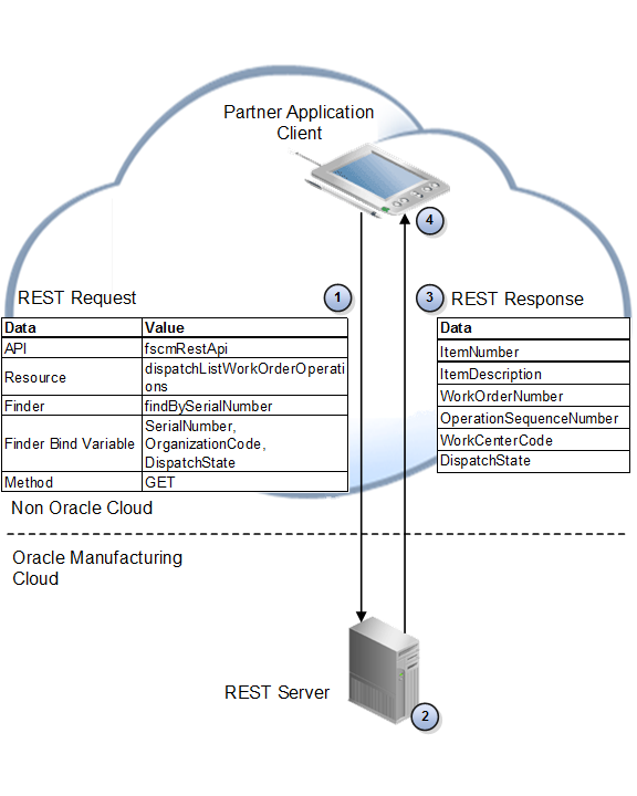

Get Work Order Details According to Assembly Serial
Assume you create a solution that allows John Brown, a discrete manufacturer, to use a mobile client to connect to your partner application, and then use a REST API. John uses the partner application to scan the serial of assembly PRE5712, and then uses the dispatchListWorkOrderOperations resource to get the details of the serial.
Flow where your customer uses the partner application to scan the serial of assembly PRE5712, and then uses the dispatchListWorkOrderOperations resource to get the details of the serial.
Here's a typical application processing flow for the scenarios:
  1. Send a REST request to get work order details for assembly serial PRE5712.
  2. The response payload includes details that describe the results of the request.
  3. Your partner application extracts the values for the following attributes from the response payload, and then displays them in the client.
    Attribute
    Description
    ItemNumber
    Value that uniquely identifies the Assembly Number. For example, MI-1234.
    ItemDescription
    Text description of the Assembly. For example, 5.5" mobile.
    WorkOrderNumber
    Number that identifies the work order. For example, M1-1208.
    OperationSequenceNumber
    Number that identifies the work order operation. For example, 20.
    WorkCenterCode
    Code that uniquely identifies the work center. For example, YLX_WC_02.
    DispatchState
    Dispatch state of the assembly. For example, READY.
Example URL
Use this resource URL format.
GET
curl -u username:password "https://servername/fscmRestApi/resources/version/dispatchListWorkOrderOperations?finder=findBySerialNumber;SerialNumber=PRE5712,OrganizationCode=M1,DispatchState=READY"
Example Response
Here's an example of the response body in JSON format.
	"items" : [ {
		"OrganizationId" : 207,
		"OrganizationCode" : "M1",
		"OrganizationName" : "Tall Manufacturing",
		"WorkAreaId" : 300100091177813,
		"WorkAreaCode" : "YLX_WA_02",
		"WorkAreaName" : "YLX_WA_02",
		"WorkCenterId" : 300100091177814,
		"WorkCenterCode" : "YLX_WC_02",
		"WorkCenterName" : "YLX_WC_02",
		"WorkCenterDescription" : "YLX_WC_02",
		"WorkOrderId" : 300100093180128,
		"WorkOrderNumber" : "M1-1208",
		"WorkOrderDescription" : "WO for prototype",
		"InventoryItemId" : 300100039626650,
		"ItemNumber" : "MI-1234",
		"ItemDescription" : "5.5" mobile",
		"OperationId" : 300100093180130,
		"OperationSequenceNumber" : 20,
		"OperationName" : "OP20",
		"OperationDescription" : "Assemble",
		"DispatchState" : "READY",
		"Quantity" : 10,
		"UnitOfMeasure" : "Each",
		"PlannedStartDate" : "2016-10-27T04:38:00-07:00",
		"PlannedCompletionDate" : "2016-10-27T04:38:00-07:00",
		"WorkOrderPriority" : null,
		"PurchaseOrderId" : null,
		"PurchaseOrder" : null,
		"PurchaseOrderLineId" : null,
		"PurchaseOrderLine" : null,
		"CustomerId" : null,
		"CustomerName" : null,

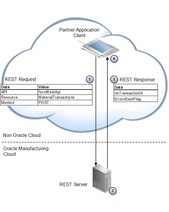

Post the Material Transaction for the Work Order Operation
The client scans the serial number of the component to issue, DZ1234, and then posts the material transaction in Oracle Manufacturing Cloud to issue the component to the assembly.
Flow where The client scans the serial number of the component to issue, DZ1234, and then posts the material transaction in Oracle Manufacturing Cloud to issue the component to the assembly.
  1. The client gets the component quantity issued to the serial. Send a REST request to post one material transaction in plant M1, for work order M1-1208, operation sequence 20, and component CO-1234.
  3. Your partner application extracts the values for these attributes from the response payload, and then displays them in the client. This table includes only some of the attributes of the Material Transaction resource.
    Some resources contain only a few attributes. Others might contain several hundred attributes.
    Attribute
    Description
    InvTransactionId
    Value that uniquely identifies the material transaction number. For example, 22386581.
    ErrorsExistFlag
    A flag that indicates whether the transaction succeeded or failed.
Example URL
POST
curl -u username:password -X POST -H "Content-Type:application/vnd.oracle.adf.resourceitem+json" -d 'request payload'
"https://servername/fscmRestApi/resources/version/materialTransactions"
Example Request
Here's an example of the request body in JSON format.
	"SourceSystemCode" : "Client",
	"SourceSystemType" : "EXTERNAL",
	"MaterialTransactionDetail" : [
		"SubinventoryCode" : "Stores",
		"TransactionDate" : "2016-11-01 07:55:49",
		"TransactionNote" : "Issued from Mobile client",
		"TransactionQuantity" : 1,
		"TransactionTypeCode" : "MATERIAL_ISSUE",
		"TransactionUomCode" : "Ea",
		"WoOperationSeqNumber" : 20,
		"AssemblySerialNumber" : "PRE5712",
		"InventoryItemNumber" : "CO-1234",
		"TransactionSerial" : [{
			"SerialNumber":"DZ1234"
Example Response
	"ErrorsExistFlag" : "false",
	"MaterialTransactionDetail" : [ {
		"InvTransactionId" : 22386581,
		"WorkOrderNumber" : " M1-1208",
		"WoOperationSequenceNumber" : 20,
		"TransactionTypeCode" : " MATERIAL_ISSUE",
		"ItemRevision" : "A",
		"TransactionUnitOfMeasure" : "Each",
		"Locator" : null,
		"WorkDefinitionCode" : null,
		"WorkOrderType" : null,
		"WorkOrderSubType" : null,
		"SourceHeaderReference" : null,
		"SourceHeaderReferenceId" : null,
		"SourceLineReference" : null,
		"SourceLineReferenceId" : null,
		"ReasonCode" : null,
		"POLineNumber" : null,
		"PONumber" : null,
		"SoldToLegalEntityName" : null,
		"ErrorMessages" : "",
		"ErrorMessageNames" : "",
		"TransactionSerial" : [ {
			"LotNumber" : null,
			"SerialNumber" : "DZ1234",
			"SerialNumberTo" : "DZ1234",
