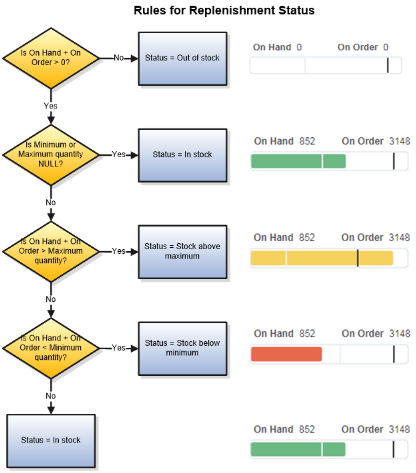

Status Meter Gauge
With the status meter gauge, you have a visual indicator of your replenishment item's status. There are quantities that make up the status gauge. These quantities are also available as separate columns for export.
The on-hand quantity represents the total quantity of an item stored at either the organization or the subinventory.
The on-order quantity includes the sum of replenishment requests, purchase requisitions, open purchase orders, shipments, and receipts. The on hand and on order quantities, are added to become the projected on-hand quantity and is compared against the minimum and maximum quantities to give you the replenishment status.
With this comparison, replenishment can have one of these statuses:
Out of stock: If the available quantity is less than 0.
In stock: If the minimum and maximum quantity is null or if the available quantity is greater than the minimum quantity.
Stock above maximum: If the available quantity is greater than the maximum quantity.
Stock below minimum: If the available quantity is less than the minimum quantity.
This figure illustrates the rules for replenishment status:

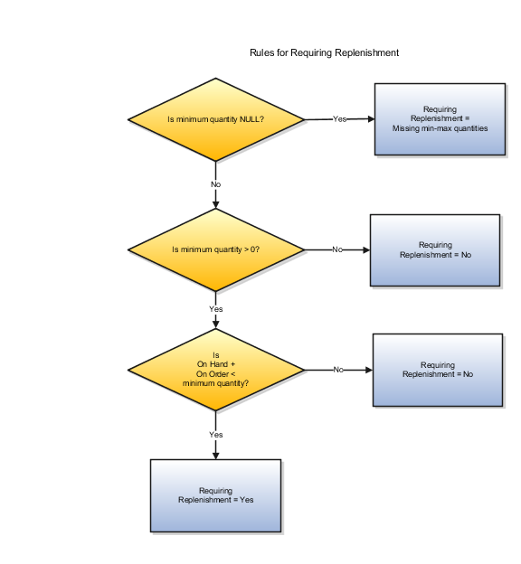

Requiring Replenishment
With requiring replenishment, you can return all replenishment items that must be replenished in order to avoid a stock out. You can also use this criterion to return items that don't have minimum and maximum quantity thresholds defined.
The rules for requiring replenishment include these steps:
If the minimum quantity for the item is null, then replenishment is unknown, and requiring replenishment will return the Missing min-max quantities error.
If the minimum quantity is 0, then replenishment isn't required.
Note:Setting the minimum quantity to 0, you can temporarily suspend replenishment of an item.
If the projected on-hand quantity is greater than the minimum quantity, then replenishment isn't required.
If the projected on-hand quantity is less than the minimum quantity, then replenishment is required.
This figure illustrates the rules for requiring replenishment:
