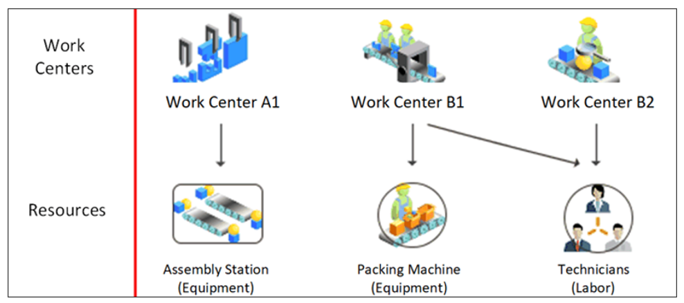

Here's an example of how you can assign the resources to work centers.
Figure 4 An illustration of how you can assign the resources to work centers.
