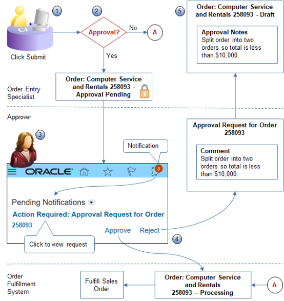

How Approval Works
Assume the sales order total exceeds $10,000 and your order administrator set up an rule.
If the sales order total exceeds $10,000, then get approval.
Send the approval request to your manager.
Here's the flow that this example uses.
Note
You create a sales order in the Order Management work area, then click Submit.
If your order administrator set up approvals, and if the sales order meets the approval rule, then Order Management sets the status to Approval Pending, locks the sales order so you can't edit it, adds a lock icon immediately to the right of the order status, then sends a notification to the approver.
To get details about the current state of the approval process, in the order header, click View Approval Information.
Order Management adds a notification to the banner in the approver's work area. The approver can click the request to get details about it, add a comment, then approve or reject the request.
If the approver.
Approves. Order Management sets the order status to Processing and sends the sales order to order fulfillment.
Rejects. Order Management unlocks the sales order, sets the order status to Draft, allows the approver to add a comment, then sends the sales order back to you for rework.
If the approver rejects the approval request, then Order Management displays a comment that the approver added. It displays the comment as a note in the Approval Notes tab of your sales order. You can now modify the sales order and resubmit it to restart the approval process.
