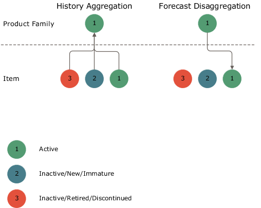

How Statistical Forecasts Are Disaggregated by Default
Whether a product combination receives a disaggregated statistical forecast depends on the forecast status of the combination, which can be one of the following:
Forecast Status |
Description |
1 |
Active A product combination has this forecast status if the demand is wholly or partially before the period specified in the PeriodsUntilActive forecasting parameter and wholly or partially within the period specified in the PeriodsUntilInactive forecasting parameter. Only product combinations with this forecast status receive a disaggregated forecast by default. |
2 |
Inactive/New/Immature A product combination has this forecast status if the demand is wholly within the period specified in the PeriodsUntilActive forecasting parameter. |
3 |
Inactive/Retired/Discontinued A product combination has this forecast status if the demand is wholly before the period specified in the PeriodsUntilInactive forecasting parameter. |
These points explain the default disaggregation of statistical forecasts:
The forecast status measure is identified on the basis of the output measure for the forecasting profile and calculated for a product combination after these criteria are considered:
The values of the PeriodsUntilActive and PeriodsUntilInactive forecasting parameters.
The value of the associated generate forecast measure for the product combination.
Note:The generate forecast measure is an override for the forecast status measure. Edit the generate forecast measure for only those active product combinations that must not receive a forecast. Don't use this measure if you want inactive product combinations to receive a forecast.
Depending on the input measure for the forecasting profile, the history average measure is selected. The history average for the product combination is then calculated on the basis of the GlobalAllocationPeriods forecasting parameter.
The input history for all product combinations is collected irrespective of their forecast status (Active, Inactive/New/Immature, or Inactive/Retired/Discontinued) and aggregated to active product combinations at a higher level for generating the forecast.
The generated forecast is disaggregated to only active product combinations at the lowest level on the basis of the history average (contained in the history average measure) and disaggregation parameters for the output measure of the forecasting profile.

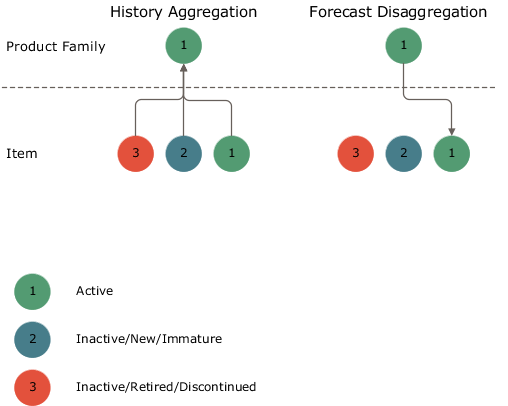

As depicted in this figure, history is collected from active, inactive/new/immature, and inactive/retired/discontinued product combinations and aggregated to active product combinations at a higher level, and the forecast is disaggregated to only active product combinations at the lowest level.
