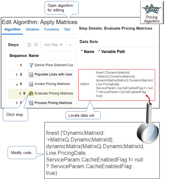

On the Edit Algorithm page, click the step that contains
Evaluate Pricing Matricesin the Name column. -
In the Step Details area, click the step that contains Matrix in the Name Column, then examine the code in the Variable Path column.
finest {'DynamicMatrixId: '+MatrixQ.DynamicMatrixId}; dynamicMatrix(MatrixQ.DynamicMatrixId, Line.PricingDate, ServiceParam.CacheEnabledFlag != null ? ServiceParam.CacheEnabledFlag : true)Here's the format of the path to the Matrix data set.
