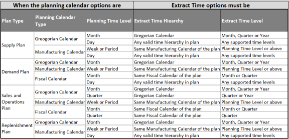

The extract time hierarchy depends on the plan type, the planning calendar associated with the plan, and the planning time level. Validation rules apply for the Extract Time Hierarchy field, based on the type of plan.

Select a specific time level to extract. The list of values includes all levels based on the plan type and your selection in the Extract Time Hierarchy field. The valid values and defaults are as follows:
               Manufacturing calendar: Week, Period (Default is Week)
               Fiscal Calendar: Month, Quarter (Default is Month)
               Gregorian Calendar: Month, Year (Default is Month)
The extract time level depends on the plan type, the planning calendar associated with the plan, and the planning time level. The Extract Time Level selection is subject to validation for each plan type.
| Plan Type | Rule |
| Supply plan | Largest supply planning bucket or above. For example:
| Demand plan | Planning time level of the plan or above. |
| Demand and Supply plan | Largest supply planning bucket or above. For example:
| Sales and Operations plans | Planning time level of the plan or above. |
| Replenishment plan | Planning time level of the plan or above. |
For a demand plan that uses a hybrid time hierarchy, in the Extract Time Level field, you can select a parent of the Hybrid time level for the hybrid time hierarchy that you selected as the planning calendar. For a manufacturing hybrid hierarchy, you can select the Week or Period level. For a Gregorian hybrid hierarchy, you can select the Month, Quarter, or Year level. For a fiscal hybrid hierarchy, you can select the Month, Quarter, or Year level.
