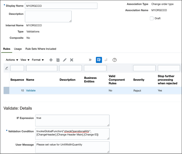

- Set up Item Rule in the Rules tab of the Edit Rule Set page of the change
order.
InvokeGlobalFunction("validateAttrVal", [ChangeHeader].[Change Header Main].[Change ID])Here's how you define a rule in the Edit Rule Set page
- Change order criteria: Define the criteria in the Workflow tab of the Edit
Change Order Type page.
Add the M1ORGCCO rule as the exit criteria for interim approval status.
