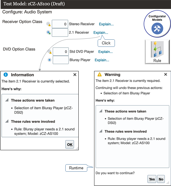

You create a rule:
Use the Bluray Player only with a 2.1 ReceiverYou then test your model.
During the test, select 2.1 Receiver and select Bluray Player, click Explain next to 2.1 Receiver, then examine the details in the Information dialog.
Information
The item 2.1 Receiver is currently selected.
Here's why:
These actions were taken:
Selection of item Blueray Player (zCZ-DS12)
These rules were involved:
Rule: Bluray player needs a 2.1 sounds system; Model: zCZ-AS100
The Information dialog identifies the rule that configurator applied and why it applied that rule.
At run time, select Stereo Receiver and select Bluray Player, then examine the details in the Warning dialog that configurator displays.
Warning
The item 2.1 Receiver is currently required.
Continuing will undo these previous actions:
Here's why:
The Warning dialog tells you what item is required, what will happen if you continue, identifies the rule that configurator applied, and why it applied that rule.
