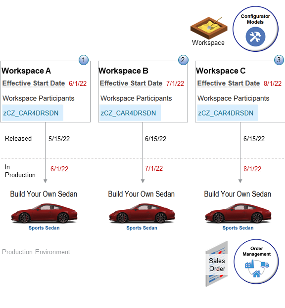

Manage Releases Across Workspaces
Consider an example where you have three workspaces, all of them have the same zCZ_CAR4DRSDN model as a participant, and the model is in draft status in all workspaces.
         What the Numbers Mean
                         Number  |
                     You Set The Effective Start Date in Workspace A To | You Release it On |
                         Configurator Puts the Model Into Production On  |
| 1 | 6/1/22 | 5/15/22 | 6/1/22 |
| 2 | 7/1/22 | 6/15/22 | 7/1/22 |
| 3 | 8/1/22 | 6/15/22 | 8/1/22 |
Note
Notice how versions of the model move from draft to production after you release the workspace.
You can release a workspace before its effective start date, but the model doesn't go into production until after the effective start date.
You can release different workspaces that contain the same model on the same date as long as the effective start dates of these workspaces aren't the same. If you do this, then you must release the workspace that has the effective start date that happens first, and then release the workspace that has the effective start date that happens later.
Releasing an updated model might affect other models that also have the model but that aren't part of the workspace that you release. Assume you release workspace A. If you haven't released workspace B, and if the model's effective start date in workspace B happens after the model's effective start date in workspace A, then Configurator will apply whatever changes that you made to the model in A to the model in B.
