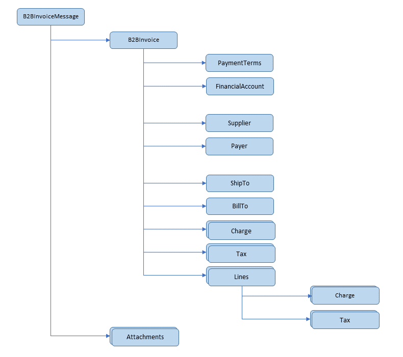

Figure 1
Figure 1 shows the structure of the inbound payload that's received for the Oracle-1-0-B2B-Invoice-In message:
B2B Invoice Inbound Payload Structure

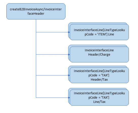

Figure 2
Figure 2 shows the structure of the transformed payload that's passed onto the application:
B2B Invoice Transfer Payload Structure
