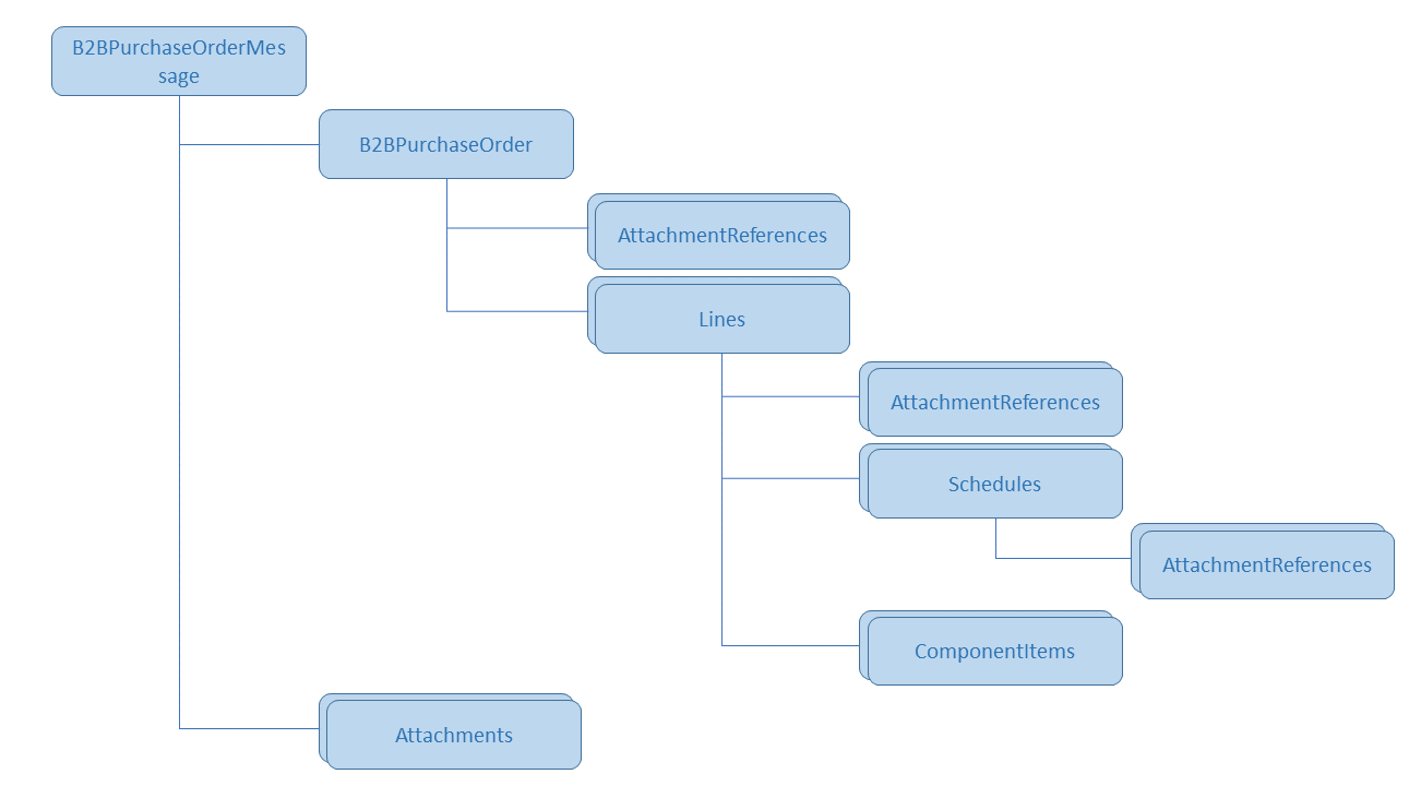

Figure 1 shows the structure of the payload that's received from the customer for the predefined message definition Oracle-1-0-B2B-Purchase-Order-In.
Figure 1

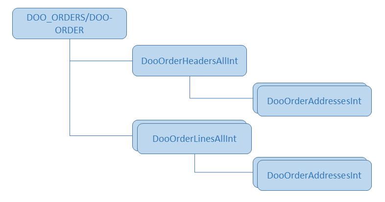

Figure 2 shows the structure of the transformed payload that is sent to the application for the predefined message definition Oracle-1-0-B2B-Purchase-Order-In.
Figure 2
