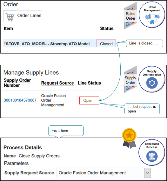

Close Supply Orders That Are Open
Use a scheduled process to close supply orders that are open but that don't have pending actions.
If an unexpected system downtime or unexpected technical error happens, then Supply Orchestration might not update the status for a supply order, and the supply order might be left in an open status even though fulfillment is done for the supply order.
Assume you create and submit sales order 86954 in the Order Management work area, and Supply Chain Orchestration creates supply order 300100184370687 to fulfill 86954. A week later you experience a power outage. You restore power then notice that the status for all fulfillment lines in 86954 is Closed, but the status for 300100184370687 remains Open.
use the Close Supply Orders scheduled process to fix the problem.
You notice a similar situation for 20 other sales orders. You can use the Close Supply Orders scheduled process to fix the problem.

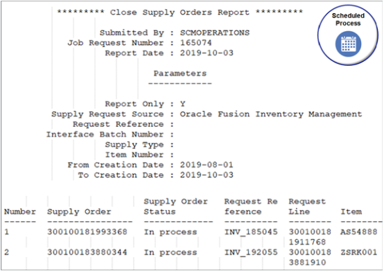

  5. On the Overview page, in the search results, click Refresh until the status for your process is Succeeded.
  6. In the Log and Output area, next to Attachment, click the link inside the parentheses, such as (1 more.), then click the .txt file, such as 103648.txt.
  7. Examine the report output.
Here's part of an example report.
