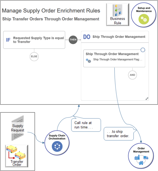

Example
Here's an example rule.
If Supply Chain Orchestration receives a transfer order, then ship it through Order Management.
Here's the rule you create.
Note.
Supply Chain Orchestration receives a supply request for a transfer order.
Supply Chain Orchestration calls your rule at run time.
The rule ships the transfer order through Order Management.

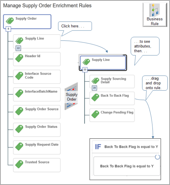

Use the Supply Order's Hierarchy
Use the tree on the Manage Supply Order Enrichment Rules page to find attributes you can use in your rule, then add them.
The tree displays the supply order hierarchy.
A supply order is an object in Supply Chain Orchestration.
A supply order includes entities, such as Supply Lines.
Each entity includes attributes. For example, here are some attributes in the Supply Lines entity.
Supply Sourcing Detail
Back to Back Flag
Change Pending Flag
Contract Manufacturing Flag
Destination Business Unit
And many others
To add an attribute to your rule, click the attribute, drag, then drop it onto the rule.
For example, drag the Back to Back Flag attribute onto the If statement of your rule.
You can use the tree to set up a wide range of conditional logic that meets your business requirements. Here are a few examples.
If the Back to Back Flag attribute is equal to True
If the Supply Line Status attribute is equal to Closed
If the Need By Date attribute is before 4/19/2019 6:02 PM in the Make Order Details entity of the Supply Sourcing Detail entity of the Supply Line entity

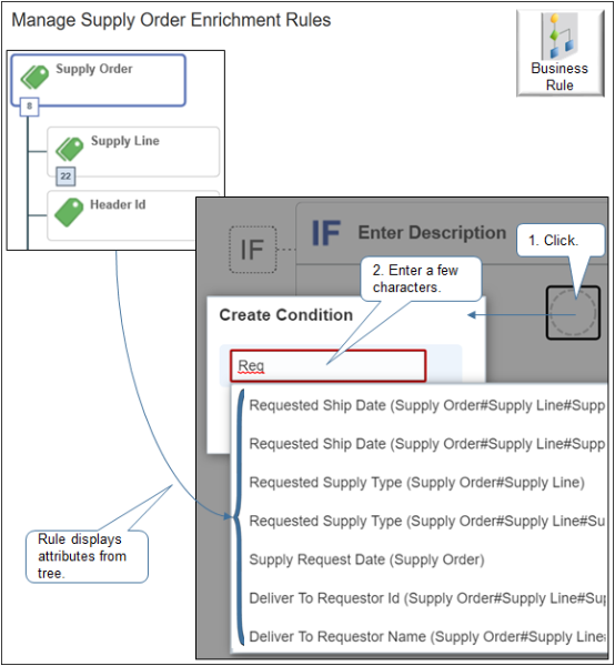

If you prefer not to use the tree, you can search directly in the If statement or Then statement for the entity, attribute, value, and so on.
For example, click New Condition in the If area, then enter Req in
the Create Condition dialog. The rule gets all attributes from the
tree that contain the string req, then
displays them in a list.
Each choice in the list includes the attribute name, and then the location of the attribute in the hierarchy. For example.
Choice in the List |
Description |
Supply Request Date (Supply Order) |
Supply Request Date attribute of the Supply Order object. |
Requested Supply Type (Supply Order#Supply Line) |
Requested Supply Type attribute in the Supply Line entity of the Supply Order object. |
Requested Supply Type (Supply Order#Supply Line#Supply Sourcing Detail) |
Requested Supply Type attribute in the Supply Sourcing Detail entity of the Supply Line entity of the Supply Order object. |
Requested Ship Date (Supply Order#Supply Line#Supply Sourcing Detail#Buy Order Details) |
Requested Ship Date attribute in the Buy Order Details entity of the Supply Sourcing Detail entity of the Supply Line entity of the Supply Order object. |

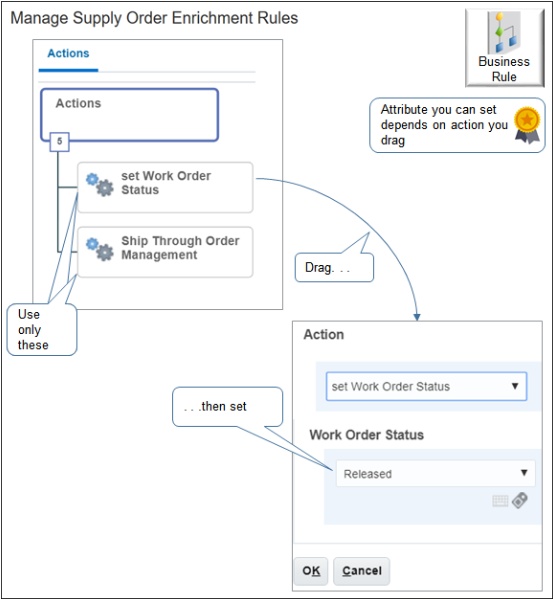

Set the Action
Use the Actions tree to drag an action onto the Do area.
Note.
Drag an action.
Action
Description
Set Work Order Status
Set the Work Order Status attribute to Unreleased or Released.
Ship Through Order Management
To ship the order through Oracle Order Management, set this action to Yes.
Don't use any other action.
