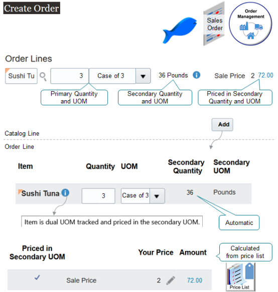

Create an order, search for your item on the catalog line, then add it to an order line.

  2. Search for the Sushi Tuna item on the catalog line.
    The catalog line sets the unit of measure to the primary, by default. It also displays primary and secondary attributes which makes it easy to see the conversion.
    For this example, assume you change the Quantity to 3 and the UOM to Case of 3.
    Attribute
    Value
    Quantity
    3
    This is the primary quantity.
    UOM
    Case of 3
    The primary UOM of the item is Each. You can change it to any UOM that's in the primary UOM's class, such as Case of 3.
    Secondary Quantity
    36
    The catalog line uses your conversion rules to automatically calculate the secondary quantity.
    • 1 case contains 3 tuna.
    • 1 tuna equals 4 pounds.
    • 3 tuna multiplied by 4 pounds means each case weighs 12 pounds.
    • 12 pounds for each case multiplied by the primary quantity of 3 equals a secondary quantity of 36.
    Secondary UOM
    Pounds
    Sale Price
    2
    Line Price
    72.00
    Its the secondary quantity of 36 pounds multiplied by the unit price of 2 equals 72.00.
    Information Icon
    Let's you know that you're using dual UOM tracking on this item.
  3. Click Add, then notice that the sales order adds the values that you set on the catalog line to the order line. Here are a few more details you should take note of.
    Attribute
    Value
    Item
    Contains your dual UOM item.
    Priced in Secondary UOM
    Contains a value.
    • Selected. Pricing priced the order line according to the value in the Secondary UOM attribute on the order line. In this example, that would be Pounds.
    • Not Selected. Pricing priced the order line according to the value in the UOM attribute on the order line. In this example, that would be Each.
    Order Management gets this value from the Pricing attribute that you set in Product Information Management.

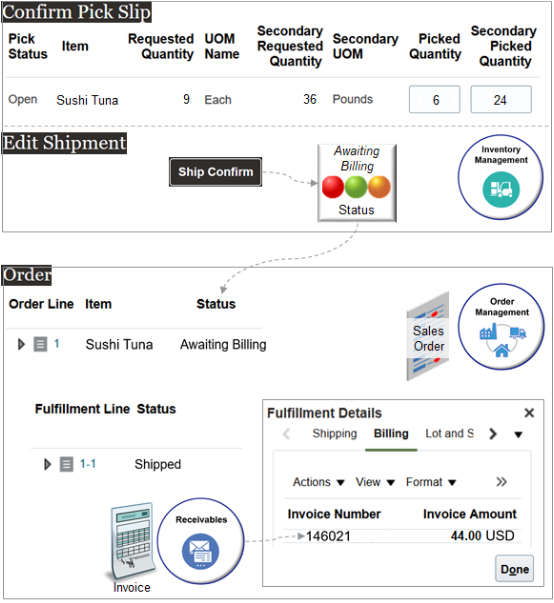

Manage Inventory
Use Inventory Management and Order Management together to track your UOMs during fulfillment.
Here's what's happening.
  • You click Submit on the sales order, then Order Management creates and sends a shipment request to Oracle Shipping.
  • Oracle Shipping creates a shipment request and populates the requested quantity and the secondary requested quantity according to the standard conversion that you set up for the item.
  • You can also use the Inventory Management work area to manually create a pick wave, confirm the pick slip, and confirm the shipment.
  • This feature maintains values for various attributes, such as Secondary Requested Quantity and Secondary UOM. It maintains and displays them throughout your dual UOM flow across applications.
  • Inventory Management lets Order Management know that it confirmed the shipment, then you use the Order Management work area to see that it updated the status on the order line to Awaiting Billing.
  • You can also use the Order Management work area to examine the status on the fulfillment line, such as Shipped, and to get the same invoice details that Oracle Receivables has on the invoice for the fulfillment line.
Notes.
  • The Requested Quantity is in the Primary UOM Each. It contains 9 because you ordered 3 cases, and each case has 3 tuna.
  • In this example, assume one of the cases sits too long on the shelf and spoils, you pick only 2 cases instead of the requested 3. The Picked Quantity is in the primary UOM Each, so you set Picked Quantity to 6 because each case has 3 tuna. Each case has 3 tuna that weigh 4 pounds each, so Inventory Management automatically sets the Secondary Picked Quantity to 24 because each case weighs 12 pounds and you picked 2 cases.
In this example, you set the picked quantity to a value that's different from the requested quantity. Let's see how you do that.

  2. Confirm the pick slip.
    • On the Inventory Management page, click Tasks > Confirm Pick Slips.
    • On the Confirm Pick Slips page, search for the value.
      Attribute
      Value
      Pick Wave
      1307257
      • In the search results, click the link in the Pick Slip column.
      • In the Picks area, note the values.
        Attribute
        Value
        Requested Quantity
        Maximum Picked Quantity
        9
        Note that its the quantity in the primary UOM, Each. You ordered 3 cases of tuna, and each case has a quantity of 3, so the total is 9.
        Secondary UOM
        Pounds
        36
        The conversion rule that you created calculates this value, which is a conversion between the item's primary unit of measure Each and the item's secondary unit of measure Pounds.
        Empty
      • Set the value.
        Attribute
        Value
        Picked Quantity
        9
        Its the quantity in the primary UOM Each.
      • Notice that the work area automatically updates the Secondary Picked Quantity according to the value that you set in the Picked Quantity.
        Attribute
        Value
        36
        Its the quantity in the secondary UOM Pounds.
      • You set the Deviation Factor earlier in this procedure to +/- 10%. 10% of 36 is 3.6, so you can set the Secondary Picked Quantity to a:
        • Low of 32.4 (36 minus 3.6).
        • High of 39.6 (36 plus 3.6).
        There's some variability of the weight for tuna. You measured the weight of the two cases you picked and find that they lost weight through evaporation. They actually weigh 34 pounds, not 36 pounds. So you manually decrease the value from 36 to 34, which is above the low range that the deviation allows.
        Attribute
        Value
        34
        The Deviation Factor attributes that you set for the item in Product Information Management controls the value that you can set.
        If you find that the cases you picked weigh less than 32.4 or more than 39.6, then you can't use them. You must pick some other cases.
      • Set the value, then click Confirm > Confirm and Go to Ship Confirm.
        Attribute
        Value
        Ready to Confirm
        Selected.
    • Confirm the shipment.
      • On the Edit Shipment page, confirm the values, then click Ship Confirm.
        Attribute
        Value
        Line Status
        Staged
        Requested Quantity
        Staged Quantity
        9
        Its the quantity in the primary UOM, Each.
        34
        36
        Inventory Management sends an update to Order Management that it confirmed the shipment, and Order Management updates the status for the order to Awaiting Billing.
Here's a summary of the values on the shipment line.
Item
Order Line
Line Status
Quantity UOM
Requested Quantity
Staged Quantity
Secondary Quantity UOM
Sushi Tuna
1
Staged
Each
9
9
34
Pounds

    Attribute
    Value
    Status
    Shipped
  3. Click Actions > View Fulfillment Details.
  4. In the Fulfillment Details dialog, click Billing, then notice the values for the line.
    Attribute
    Value
    Invoice Number
    146021
    Invoice Amount
    68.00 USD
    These values indicate that the flow has successfully invoiced the sales order.
