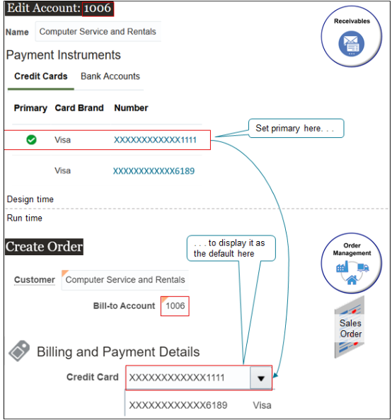

Add New Credit Card and Make it Primary
Assume you need to add a credit card for your Computer Service and Rentals customer and make it the primary card.
Note
  • You add a credit card to the account in the Accounts Receivable work area.
  • You can set the card as the primary card when you add it.
  • At run time, Order Management selects and displays the primary card, by default. It also makes the other cards that you add in the Accounts Receivable work area available on the sales order.

  6. On the Edit Account page, in the Payment Instruments area, in the Credit Cards list, click Create a Credit Card. Its the icon that looks like a page.

  2. Go to the Order Management work area and create a sales order.
    Attribute
    Value
    Customer
    Business Unit
    Vision Operations
    Bill-to Account
    1006
    Notice that this is the same value you clicked on the Manage Customers page.
  3. Click Billing and Payment Details.
  4. On the Billing and Payment Details tab, set the value.
    Attribute
    Value
    Payment Method
    Credit Card
  5. In the Payment Details area, verify that the attribute value defaults to the primary card.
    Attribute
    Value
    Credit Card
    XXXXXXXXXXXX1111
