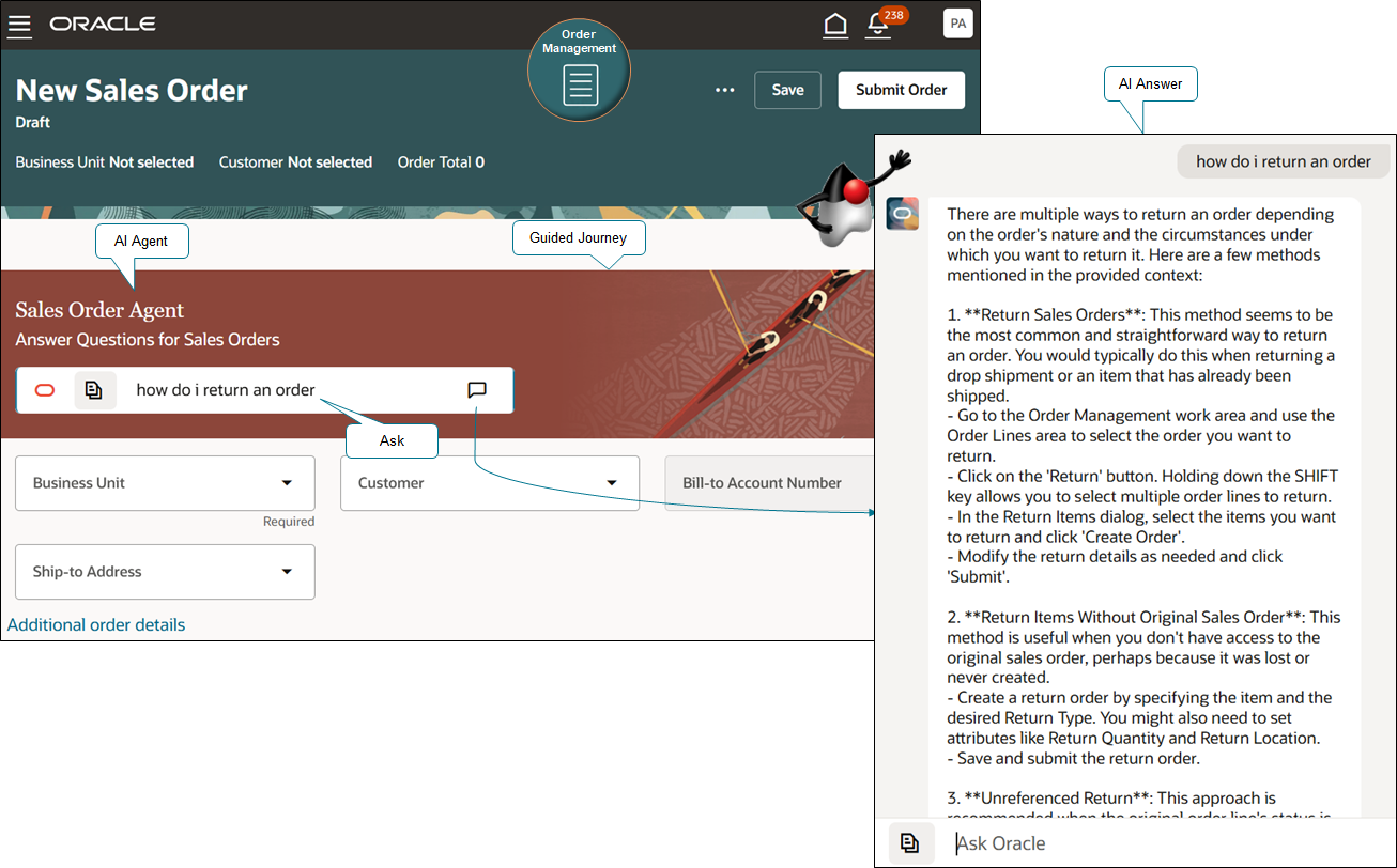

Add and Test Your Journey
  1. Go to Home Page > My Client Groups > Show More > ctrl+f, search for then click Guided Journey.
  2. On the Guided Journey page, click Create, set the values, then click Create Draft:
    Attribute Value
    Name Guided Journey for Order Management
    Code GUIDED_JOURNEY_FOR_ORDER_MANAGEMENT
  3. On the Guided Journey for Order Management page, add this task, then click Save > Activate:
    Attribute Value
    Task Name Sales Order Agent
    Task Description Answer Questions for Sales Orders
    Task Type Agent
    Configuration Sales Order Agent
    The Order Management work area will display the Task Name and Task Description on the journey's banner. We recommend that you use headline capitalization so it's consistent with the work area's style.
  4. Go to Home Page > Order Management > Show More > Sales Orders (New).
  5. Click Settings and Actions > Edit Page in Visual Builder Studio.
  6. In Visual Builder Studio, set the OMOrderPageJourneyCode property to GUIDED_JOURNEY_FOR_ORDER_MANAGEMENT, then click Publish.
  7. Use the guided journey to ask various questions. Verify them against your source documents to make sure the answers are correct.
    Click the icon immediately to the left of the prompt on the guided journey, then select one of the sources that you uploaded. Ask the same question for different sources. Notice how the answer provides content only from the source that you select.
