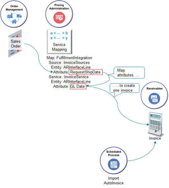

  • Use the Pricing Administration work area to create a service mapping that maps an attribute value from the sales order in Order Management, such as the requested ship date, to the GL Date attribute in Oracle Receivables. You modify the FulfillmentIntegration service mapping. It doesn't affect pricing, but it does use some of the same processing that Pricing uses. That's why its in the Pricing Administration work area.

Enable the Invoice option in the Enable Custom Payloads for Downstream Integration feature. For details, see Get Started with Integrating Order Management with Other Oracle Applications.
Set Up Service Mapping
Set up the service mapping so it can map the GL Date attribute.

    • On the Edit Service Mapping page, click Sources.
    • In the Source List, click the row that has InvoiceSources in the Source column.
    • In the InvoiceSources area, on the Entity Mappings tab, click that row that has ARInterfaceLine in the Entity column.
    • In the ARInterfaceLine area, on the Attribute Mappings tab, click Actions > Add Row, set the values, then click Save.

      For example, set GL Date only for business units 204 and 205, and set it to the requested ship date.
      OrgId in [204,205]?RequestShipDate:null
      View Object Attribute
      To populate your date according to an attribute, leave Expression empty and specify the attribute in View Object Attribute.
      For example, to set the GL Date to the same value as the requested date, enter RequestShipDate in View Object Attribute.
