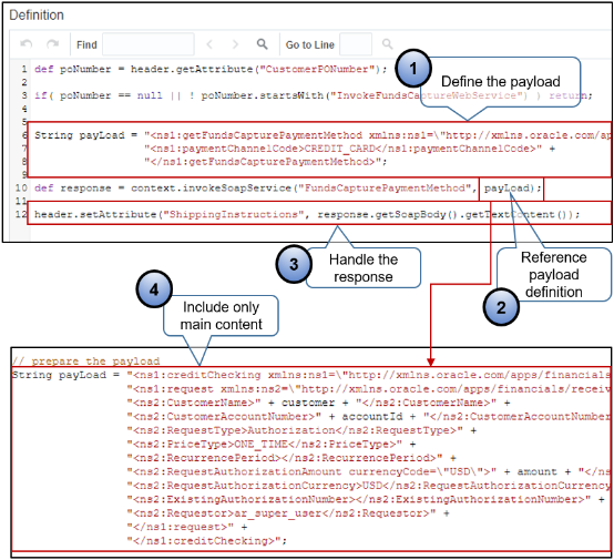

Create the Payload
Note
Create the payload. This example uses
String payLoadtohard codethe payload as a string. You can also use other techniques to meet your requirements, such as defining variables in the payload. -
Reference your payload definition in a parameter of the invokeSoapService method. This example references string
payLoad. -
Use the getSoapBody method to handle the response that the web service sends in reply to your request. Your extension can receive the response, parse it, then extract the details it requires from the response.
Create your payload so it includes only the main content. Don't include envelope or body details. invokeSoapService expects only the main content. It will add envelope and body details.
Extract Details from Web Service Response
The getSoapBody() call on the response object in a web service response is an instance of Java class for a SOAP body (Simple Object Access Protocol). For details, see Interface SOAPBody. Use the methods that are available on these interfaces to extract details from a web service response.
This example order management extension uses methods from these interfaces to extract data from the response.

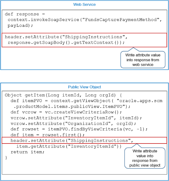

Inspect Payloads When You Use Web Services or Public View Objects
It might be difficult to examine the response from a web service or from the view criteria of a public view object. Use the setAttribute method during development to get values for the attributes that your code references, display them in the Order Management work area, then examine these values to verify your code returns the values you expect.
For example, assume your extension references shipping instructions. You can use this code to write the contents of ShippingInstructions into the response from the web service.
header.setAttribute("ShippingInstructions", response.getSoapBody().getTextContext());
You can write the same data into the response from a public view object.
Make sure you convert your test code to log files or comment it ( // ) before you deploy to production.
You can also write a message to achieve a similar result. However, a message stops or pauses processing. Use a payload so processing can continue without interruption, and so you can view attribute values in the context of how they display in the Order Management work area, such as the Shipping Instructions attribute on the order line.
