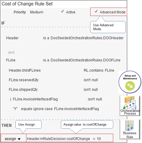

Set Up Rule for Cost of Change
         Note
               Set up a rule that measures the cost of change. If it's too high, then reject the change.
               In the header area of the orchestration process, next to Cost of Change Rule, click Click for Rule.
               Use Advanced Mode.
               Use the Assign action.
               Assign a numeric value to Header.mRuleDecision.costOfChange. For example: Header.mRuleDecision.costOfChange = 10

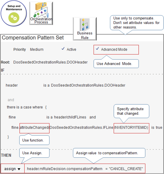

Set Up Compensation
         Note
               Use a compensation rule only to compensate change. If you must also set the values for other attributes, then use a posttransformation rule.
               In the steps area of the orchestration process, in the step that you must compensate, in the Compensation Pattern column, click Click for Rule.
               Use Advanced Mode.
               In the IF statement: -
                     Use a change function, such as attributeChanged or Changed.
                     Specify the attribute that changed. For example, if the user changed the Item attribute, then use INVENTORYITEMID.
               For example: Fline.attributeChanged(DooSeededOrchestrationRules.IFLine. INVENTORYITEMID)is trueGet the list of attributes that you can specify. For details, see Entities and Attributes That You Can Use When You Integrate Order Management with Other Oracle Applications.
               In the THEN statement: -
                     For example: header.mRuleDecision.compensationPattern = "CANCEL_CREATE"

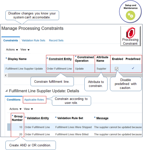

Constrain Change
Use a processing constraint:
               Disallow change that you know your fulfillment system can't accommodate, such as changing the supplier for an item that requires significant lead time for the supplier to produce.
               Make sure a channel doesn't make a change that your fulfillment system can't accommodate.
               Make sure the user includes required attributes. Assume you add your own numeric attribute x for invoicing, and invoicing requires attribute x to calculate the invoice. You can use a constraint to make sure the user adds a value for x, and that the value is numeric.
               If a constraint doesn't meet your business requirement, then use an order management extension to validate, then display a message or warning.
         Note
               Set the Constraint Entity attribute to Order Fulfillment Line.
               If the Enabled attribute is active on a predefined constraint, then you can disable it. Disable a predefined constraint only after you make sure removing the constraint won't negatively affect your implementation.
               Use the same value in the Group Number attribute to create an AND condition across constraints. For example, if you set Group Number to 10 for condition x, and Group Number to 10 for condition y, and if conditions x and y both evaluate to True, then Order Management applies the constraint.
               Use different values in Group Number to create an OR condition. For example, if you set Group Number to 10 for condition x, and Group Number to 20 for condition y, and if condition x or y evaluates to True, then Order Management applies the constraint.
               Use the Applicable Roles tab to specify the user roles that can or can't edit an attribute according to the constraint.
               Use the Manage Processing Constraints page in the Setup and Maintenance work area.
               For details, see Manage Processing Constraints.

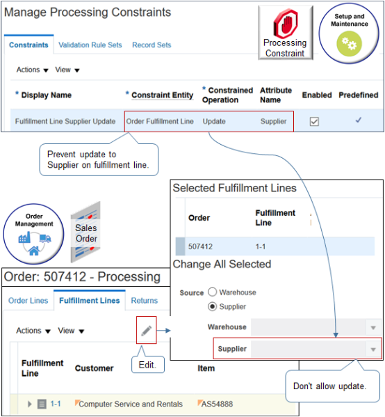

For example:
         Here's the logic that this constraint implements.
Prevent user from updating attribute Supplier on fulfillment line.
You set these values:
| Attribute | Value |
| Constraint Entity | Order Fulfillment Line |
| Constrained Operation | Update |
| Attribute Name | Supplier |
| Enabled | Contains a check mark |

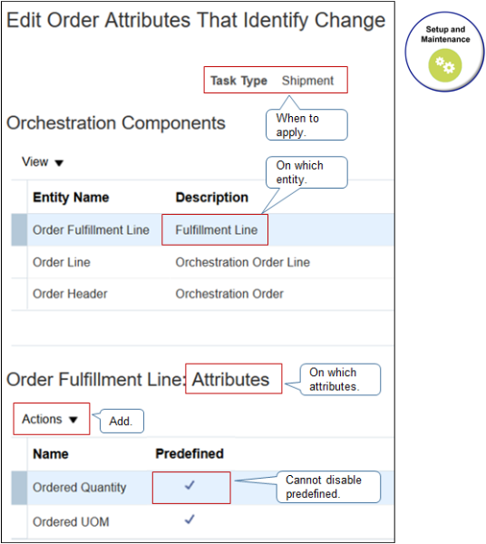

Manage Attributes That Identify Change
         You can set the Task Type attribute on an orchestration process step. The task type that you select determines the attributes that Order Management uses when it decides whether it must compensate the sales order for this step.
Order Management comes predefined to use a set of attributes for each predefined task type. You can't modify the predefined set up, but you can add more attributes. Order Management doesn't add these attributes to a new task type that you add, and it doesn't evaluate this task until you add these attributes. To add them, you must click Add All.

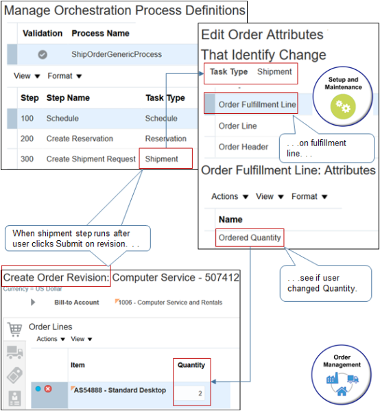

This example implements a condition.
If the user changes Quantity on fulfillment line, then perform compensation
               during shipping.
Note
               The user creates a revision, clicks Submit, and then Order Management starts the orchestration process.
               The orchestration process reaches a step that uses the Shipment task type, then examines the Manage Order Attributes That Identify Change page in the Setup and Maintenance work area to determine whether to process the change.
               For details, see Manage Order Attributes That Identify Change.
For example:
         Note
               Set the Task Type attribute to a value, such as Schedule, Reservation, Shipment, and so on, to determine when to examine the change.
               Specify an entity to determine where the attribute resides: -
                     Order Line
                     Order Header
               Specify the attribute to examine, such as Ordered Quantity.
               Use the Add action to add an attribute.
               You can add a predefined attribute, such as Ordered Quantity, but you can't disable it.
