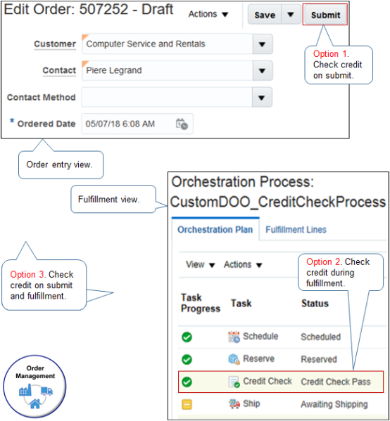

Determine When to Check Credit
Credit check during order entry or order fulfillment.
Note
Option 1. Check credit when the Order Entry Specialist clicks Submit when creating or revising a sales order.
Submit the sales order to order fulfillment but hold order lines that fail credit check.
Don't submit the sales order to order fulfillment. Instead, set the status to Credit Review Pending, and route the sales order to a credit analyst to do credit check.
Option 2. Check credit during order fulfillment. For example, add a credit check step to the orchestration process after scheduling and reserving the item, but before shipping it.
Option 3. Check credit during order entry at order submit, then check credit again during order fulfillment.
Order Management processes credit check differently during order submit or order fulfillment.

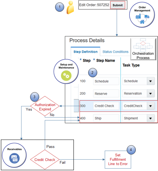

Check Credit During Order Fulfillment
Here's when you can check credit during order fulfillment.
Your fulfillment cycles run for a long time. For example, run credit check immediately before shipping to make sure credit authorization hasn't expired while process the sales order through fulfillment.
You import sales orders from a source system, the source system already checked credit, so you don't want to check credit again when submitting the order to fulfillment. But you also don't want to send the order to shipping if credit authorization expired. A long delay might exist between the time the source system checks credit and when the item is ready to ship.
Here's how it works.
Note
Order Entry Specialist clicks Submit.
The orchestration process starts fulfillment, such as schedule inventory, reserve inventory, then reaches credit check step.
If the expiration date of the credit authorization is expired, or if Order Management hasn't already done credit check at least one time, then the orchestration process sends a request to Receivables to do credit check on fulfillment lines.
If credit check passes the first time Receivables performs credit check, then it creates an authorization number and authorization expiration date.
For example, assume you do credit check during order submit on January 1, 2019, credit check passes, and Receivables sets the expiration date to January 10, 2019. If the orchestration process runs the credit check step on.
January 2 during fulfillment, then it won't run credit check again, but will instead proceed to the next orchestration process step.
January 11, then it will run credit check again.
The orchestration process sends only the fulfillment lines that require credit check. It doesn't send the entire sales order.
If credit check fails, then the fulfillment line goes into error and processing stops.
Credit analyst must adjust credit in Credit Management in Receivables.
Orchestration process will run credit check step again after credit analyst adjusts credit.

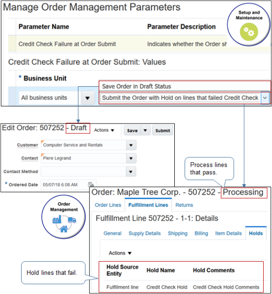

Set the Order Management Parameter
Set the value for the Credit Check Failure at Order Submit parameter.
Note
Value |
Description |
Save Order in Draft Status |
Save the sales order in the Draft status. Don't send any lines to order fulfillment. Use when.
Submit Order with Hold on Lines that Failed Credit Check |
Save the sales order in Processing status, place a hold on each order line that fails credit check, then send order lines that aren't on hold to fulfillment. Use when.
