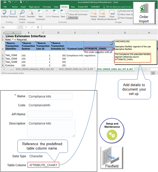

Use File Based Data Import
Use these guidelines when you use the order import template to import data for an extensible flexfield:
Assign each segment's Table Column attribute so it references the correct column in the order import template.
Use the DOO_ORDER_HDRS_ALL_EFF_B_INT worksheet to capture details for order headers.
Use the DOO_ORDER_LINES_ALL_EFF_B_INT worksheet to capture details for fulfillment lines.
Use columns, such as ATTRIBUTE_CHAR1, to capture details for each attribute.
Don't modify worksheet names or column names. Instead, add a comment.
Add a comment in Excel to document your set up.
You can use with an extensible flexfield only with these entities:
Header
Fulfillment line
Fulfillment line detail
You can't add an extensible flexfield on the order line entity. You can add one only on the order header entity or the fulfillment line entity. The template uses the phrase DOO_ORDER_LINES, but it uses details that you add on the DOO_ORDER_LINES_ALL_EFF_B_INT worksheet to interact with extensible flexfields on the fulfillment line, not on the order line. See Import Orders Into Order Management.
This example illustrates how to set up the Compliance Info segment that references the ATTRIBUTE_CHAR1 column:

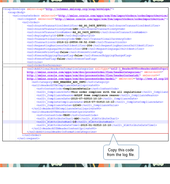

Use Web Services
Add extensible flexfield details to the payload that Order Management uses to communicate with the web service:
Use the web service named Receive Fulfillment Task Response Service with all task types. Use the DooTaskFulfillOrderResponseInterfaceComposite.
Run the Publish Extensible Flexfield Attributes scheduled process.
Copy extensible flexfield data from the log file that the scheduled process creates into the XSD file that contains your payload. Copy this data onto each object that needs extensible flexfield data. This approach helps to keep your channel system synchronized with your set up in Oracle Order Management.
Use the import service from Application Development Framework (ADF). Don't use the SOA (Service Oriented Architecture) import service.
Here's an example payload that copies one section of code from the log file into the XSD file:
See Guidelines for Using REST API, Web Services, and FBDI to Integrate Order Management.

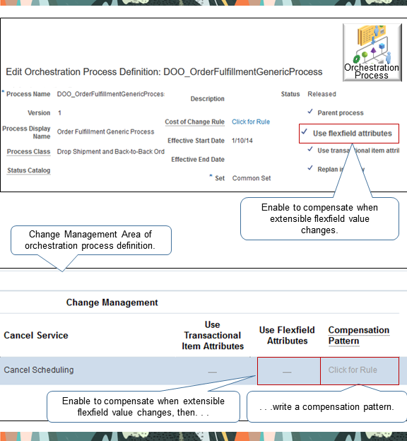

Manage Change
Identify your requirements for change management. For example, figure out whether the orchestration process must compensate when you change the value in an extensible flexfield and the action to take when you compensate, such as schedule, call Oracle Receivables, and so on.
Set up the orchestration process differently depending on whether the value that it references changes any flexfield or a specific one:
| Compensate Value For | Enable the Use Flexfield Attributes option |
| Any extensible flexfield | On the header of the orchestration process definition. |
| A specific extensible flexfield |
In the Change Management section of the orchestration process definition. Add it to the orchestration process step that references the extensible flexfield. Also set up a compensation pattern on this step. Use the compensation pattern to specify the action to do, such as Cancel, Create, Update, and so on, depending on the value that changes. Your set up can send an update when a single value changes and skip sending an update when other values change. This approach provides more detailed control regarding the compensation that you do. |
Here's an example compensation pattern:
pseudocode:
If segment3 changes, then cancel task x, and then recreate task x.
If segment4 changes, then do nothing.
If segment5 changes, then call an update service.
For a detailed example, see Compensate Sales Orders That Change.
To ignore changes to all extensible flexfield values, make sure Use Flexfield Attributes for each step in the Change Management section isn't enabled.
Change management ignores each change that you make to an extensible flexfield's value at run time when it's on order header.
