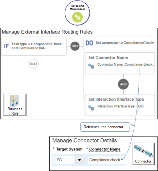

Assume you must create a routing rule.
            If the task type is Compliance Check, and if the compliance value is less than 100, then set the connector to ComplianceCheckConnector, and set the interface type to SDO.
Here's the rule that you will create.

                     In the Enter Description dialog, enter Set connector to ComplianceCheckConnector and interface type to SDO, then click OK.
               Click New Action (the dashed circle in the DO area), then click Perform an Action.
               In the Create Action dialog, set the action to Set Connector Name, then click Search.
               In the Search dialog, enter %Compli%, then click Search.The percentage symbols (%) are wildcards that search for all values before and after the text Compli. This search returns services that the Manage Connector Details page contains, and that contain the text Compli.
               In the Description area, click Compliance check system conn, then click OK.
               In the Create Action dialog, click OK.
               In the DO area, click AND > Perform an Action.
               In the Create Action dialog, set the action to Set Interaction Interface Type.
               Set Interaction Interface Type to SDO. If you are a new customer, then you must set Interaction Interface Type to SDO for any interaction interface that you set up. Use EBM only for backward compatibility to a prior update.
