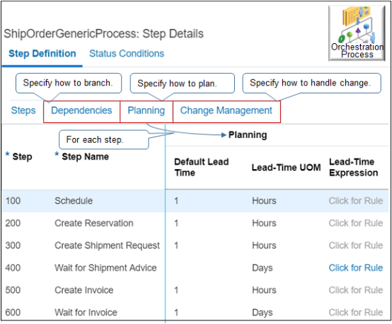

Set up Steps
You do almost all your set up on the steps.
Note
Dependencies. If your process includes a branch, then set dependencies that affect branching.
Planning. Specify how to plan fulfillment for the fulfillment line.
Set the default lead-time that the process needs to do the step.
Create a business rule that uses conditions to set lead-time.
Specify the status you expect from the fulfillment system during planning.
Specify the step that determines whether fulfillment is done.
Change Management. Specify how to manage change that happens in the fulfillment system.
Specify the task service to use for update messages or cancel messages that the fulfillment system sends to you.
Create a business rule that uses conditions to specify what to do when a change happens.
Specify dependency, planning, and change management for each step. For example, click Planning to scroll to the part of the row that contains planning attributes.

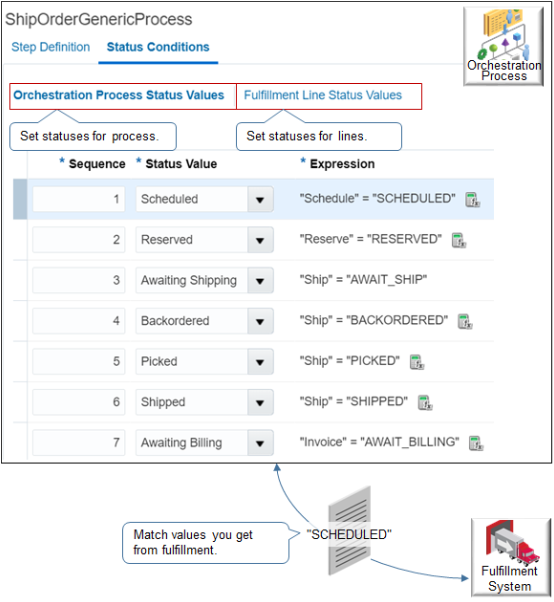

Set Up Statuses
Note
Different fulfillment systems might use different status values.
Set up statuses for your orchestration process so they match the values that your fulfillment system uses. This way, the fulfillment system understands values that the orchestration process sends, and the process knows how to handle values it receives.
For example, fulfillment system x might use SCHEDULED, and system y might use FULFILLMENT_SCHEDULED. Add values to handle both systems.
You can also set statuses for fulfillment lines.
