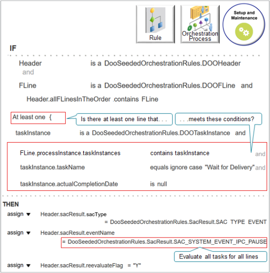

Pause Until A Task Finishes for All Lines
Assume you must wait until Shipping delivers all lines of the sales order before you send the sales order to invoicing, and then send all lines together to invoicing. So you create an orchestration process that has these steps. You use step 5 to add the pause.
Step |
Task Type |
Task Name |
1 |
Schedule |
Schedule |
2 |
Reservation |
Reserve |
3 |
Shipment |
Ship Goods |
4 |
Pause |
Wait for Delivery |
5 |
Pause |
Wait for Consolidated Billing |
6 |
Invoice |
Invoice |
Here's the pause rule that you add on step 5.
Note
Code |
Description |
Use this test to determine whether at least one fulfillment line in the sales order hasn't shipped. It asks the question.
If an order line is still doing the Wait for Delivery task, then it means there's at least one order line that Shipping hasn't delivered, and we must continue to pause before proceeding to the next orchestration process step. Wait for Delivery is an example value. You can use whatever type of pause you need while waiting for an action to happen, then move to the next the pause while you wait for billing. |
Declare the taskInstance variable, then store attributes of the task instance that the orchestration process is currently processing into this variable. DOOTaskInstance gets all the task instances for all instances of the orchestration process that are currently running for all order lines on the sales order. For example, if three task instances are currently running for three order lines, then DOOTaskInstance gets all three task instances. |
taskName identifies the value that you enter for the Task Name attribute on the orchestration process step. In this example, you entered Wait for Delivery as the Task Name on step 4. Step 4 is the pause step that determines whether any order lines are still waiting for delivery. |
Examine the value of the actualCompletionDate attribute in the taskInstance variable. If it doesn't contain a value, then it means Shipping hasn't delivered the item, and we must continue to pause. Fulfillment enters a value in actualCompletionDate to indicate when Shipping delivered the item. |
Declare the Header variable, then store attributes of the order header that the orchestration process is currently processing into this variable. |
Create a new variable named SAC and set it to the SacResult type in the DooSeededOrchestrationRules method. |

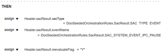

Set the value of the sacResult object on the order header to the value that SAC contains. |
Pause the orchestration process until an interprocess communication event happens. |
Use an interprocess communication (IPC) to pause according to an event across orchestration processes. Use it to evaluate the pause every time any task finishes for any line in the sales order. |
Yes, we want to reevaluate the pause. |

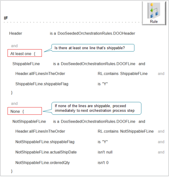

Pause Nonshippable Lines Until Shipping Ships At Least One Shippable Line
Here's what the rule does.
Pause nonshippable lines until Shipping ships at least one of the shippable lines in the sales order.
Send all nonshippable lines to invoicing as soon Shipping ships the first shippable line.
If the sales order doesn't have any shippable lines, then proceed immediately to the next orchestration process step. There's no need to pause if no lines are shippable.
Note
Code |
Description |
Use this test to determine whether at least one fulfillment line in the sales order is shippable. |
Declare the ShippableFLine variable, then store attributes of the fulfillment line that the orchestration process is currently processing into this variable. |
Declare allFLinesInTheOrder into the rules language (RL) dictionary, then set the value of allFLinesInTheOrder to the value that ShippableFLine contains. This condition makes sure allFLinesInTheOrder references a fulfillment line that the orchestration process is processing. It also makes sure you correctly declare the variable into the dictionary. You use it to examine all lines in the sales order, not only the line the current orchestration process instance is processing. |
We are only looking at fulfillment lines that are shippable. |
If none of the lines are shippable, proceed immediately to next orchestration process step. You create a separate variable, NotShippableFLine, for the None clause so its independent of the ShippableFLine variable from the At Lease One clause. |
Declare NotShippableFLine into the rules language (RL) dictionary. |
Make sure allFLinesInTheOrder references a fulfillment line that the orchestration process is processing. Examine all lines in the sales order, not only the line the current orchestration process instance is processing. |
We are only looking at fulfillment lines that are shippable. This statement is in a None clause, which asks the question.
Skip lines that don't have an actual ship date. |
Skip lines that have a zero quantity. |

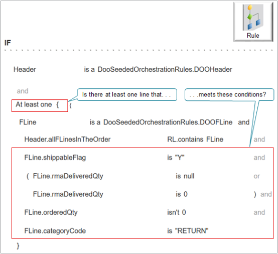

Send Nonshippable Lines and Return Lines to Invoicing
Pause nonshippable lines until Inventory Management receives all shippable lines in the sales orders.
Wait for Inventory Management to receive all shippable lines.
Automatically release the paused, nonshippable lines, then proceed to the next orchestration process step.
The orchestration process can now send the nonshippable lines and the return lines on the order to invoicing together.
Note
Code |
Description |
Use this test to determine whether at least one fulfillment line in the sales order is shippable and whether fulfillment has successfully returned the line. |
Declare the FLine variable, then store attributes of the fulfillment line that the orchestration process is currently processing into this variable. |
Declare allFLinesInTheOrder into the rules language (RL) dictionary, then set the value of allFLinesInTheOrder to the value that FLine contains. |
rmaDeliveredQty is the quantity on the return line that fulfillment has delivered to inventory. If it has no value or is zero, then it means fulfillment hasn't successfully returned the line into inventory. |
Fulfillment sets orderedQty to zero when it cancels the line. This condition makes sure we only consider lines that aren't canceled. |
Only consider return lines. Skip lines that aren't return lines. |

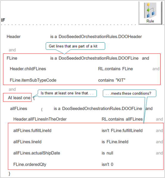

Pause Shipped Lines of a Kit Until Shipping Ships All of the Lines
Assume you order a kit that has a quantity of more than one, such as 10. All of the lines aren't available in inventory, so fulfillment splits some lines and ships part of the kit while it waits for the factory to replenish inventory. You don't want to send the shipped lines to invoicing by themselves. You need to wait until fulfillment ships all of the quantity for the kit.
Pause the shipped lines until fulfillment successfully fulfills all lines for the kit.
Automatically release the paused lines, then proceed to the next orchestration process step.
The orchestration process can now send all lines for the kit to invoicing together.
Note
Code |
Description |
Declare the FLine variable, then store attributes of the fulfillment lines that the orchestration process is currently processing into this variable. |
Declare the childFLines attribute into the rules language (RL) dictionary, then set the value of childFLines to the value that FLine contains. |
Only get fulfillment lines that are part of a kit. Skip all other lines. |
Use this test to determine whether fulfillment split at least one fulfillment line in the kit. |
Declare the allFLines variable, then store attributes of the fulfillment line that the orchestration process is currently processing into this variable. We will cycle through all the lines. |
Declare allFLinesInTheOrder into the rules language (RL) dictionary, then set the value of allFLinesInTheOrder to the value that allFLines contains. |
If fulfillment ships part of a kit, then it splits the lines in the kit, ships some lines and doesn't ship others. Let's see whether fulfillment split the lines in the kit. Notice that.
If the fulfillLineId attribute in the allFLines attribute doesn't equal the fulfillLineId attribute in the FLine variable, and if the lineId attribute in the allFLines attribute does equal the lineId attribute in the FLine variable, then we can see that fulfillment didn't split the line that we are currently examining. How do we know? The fulfillLineId identifies the fulfillment line that contains the kit. Fulfillment must maintain the relationship between the kit's fulfillment line and new lines that it creates when it splits a kit. So fulfillment assigns the lineId of each new line that it creates to the value of the fulfillLineId. |
Only consider lines that fulfillment hasn't shipped. |

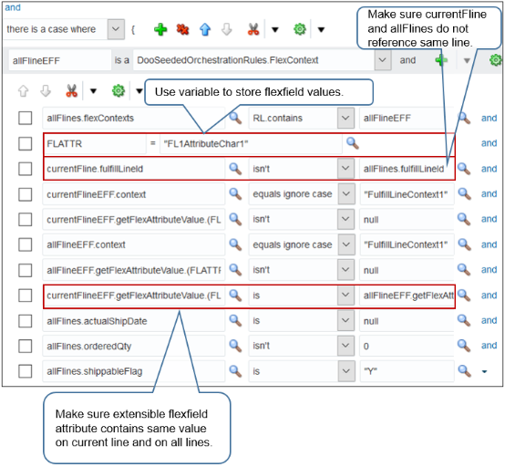

Assume you must modify the pause task so the orchestration process sends all fulfillment lines to invoicing as a single group of lines, including all the lines of a sales order that fulfillment can ship and can't ship instead of only lines that fulfillment can ship. Here's what the rule does.
Automatically releases the pause for the nonshippable lines that are part of a group as soon as Shipping finishes shipping the shippable lines.
Uses an extensible flexfield to allow the Order Entry Specialist to specify which lines are part of the group.
You can use the same Then statement that you use in the Pause Nonshippable Lines Until Shipping Ships Shippable Lines example, but the If statement is different. Add the pause task so it happens between the shipping task and invoicing task in your orchestration process.
Here's the first part of the If statement.
Note
Code |
Description |
Declare the currentFline variable, then store attributes of the fulfillment line that the orchestration process is currently processing into this variable. |
Declare currentFline into the rules language (RL) dictionary, then set the value of currentFline to the value that childFLines contains. This condition makes sure currentFline references a fulfillment line that the orchestration process is processing. It also makes sure you correctly declare the variable into the dictionary. |
Declare the allFlines variable, and set it to type DOOFLine. |
Declare the allFlines variable into the rules language dictionary, and set the value of allFlines to the value that allFLinesInTheOrder contains. This condition makes sure you correctly declare the variable into the dictionary. |
Declare the currentFlineEFF variable, and set it to type FlexContext. |
Declare currentFlineEFF into the rules language dictionary, and set the value of currentFlineEFF to the value that flexContexts contains. This condition makes sure you correctly declare the variable into the dictionary. flexContexts is a list of context rows for the extensible flexfield. FlexContext is a type of row or variable. |
Here's the second part of the If statement.
Note that the FulfillLineContext1 extensible flexfield context and the FL1AttributeChar1 segment are one group.
Assume the sales order contains 10 fulfillment lines and you must group them into two sets of five lines each. You can use.
FulfillLineContext1 and FL1AttributeChar1 to set up GROUP1 so it contains the first five lines
FulfillLineContext2 and FL1AttributeChar2 to set up GROUP2 so it contains the last five lines
Here's the code from second part of the If statement.
Code |
Description |
Declare the allFlineEFF variable, and store the value of object FlexContext into this variable. Method DooSeededOrchestrationRules contains FlexContext. |
Declare variable FLATTR (flexfield attribute), and set it to FL1AttributeChar1. You reference the FL1AttributeChar1 extensible flexfield attribute in more than one location in this rule. For efficiency, and to avoid problems because of typographical errors, you can declare FLATTR one time, set it to FL1AttributeChar1, and then reference FLATTR instead of declaring FL1AttributeChar1 more than one time. |
Proceed to the next AND only if the fulfillLineId attribute in the currentFline variable and the fulfillLineId attribute in the allFlines variable doesn't reference the same fulfillment line. |
Get the value of the flexfield context from currentFlineEFF. Proceed to the next AND statement only if the context contains the FulfillLineContext1 string.
Use the getFlexAttributeValue method to get the value of the FL1AttributeChar1 attribute from the extensible flexfield on the current fulfillment line. Proceed to the next AND only if FL1AttributeChar1 contains a value. Recall that FLATTR contains FL1AttributeChar1. |
Get the value of the flexfield context from allFlineEFF. Proceed to the next AND statement only if the context contains the FulfillLineContext1 string. |
Get the value of the FL1AttributeChar1 attribute from allFlineEFF. Proceed to the next AND only if FL1AttributeChar1 contains a value. |
Proceed to the next AND only if the extensible flexfield attribute contains the same value on the current line and on all lines. This condition makes sure these fulfillment lines are part of the same group. |
