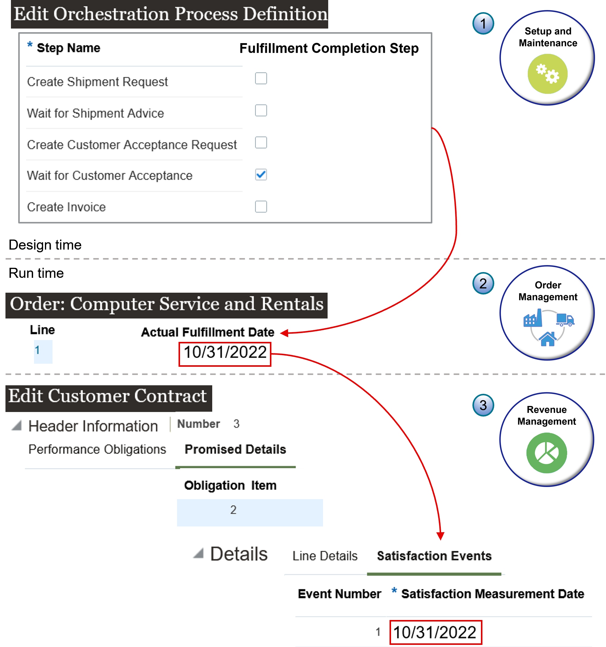

Assume you need to recognize revenue according to the date that your customer accepts the item, you ship the item on 10/26/2022, and your customer accepts the item on 10/31/2022. Here's what you need to do.
  1. Create your own custom fulfillment task.
    • Make sure the custom task has a wait step.
    • Make sure the Fulfillment Completion Step attribute on the wait step contains a check mark.
    • Make sure the custom task isn't a pause task. A pause task doesn't update the fulfillment date on the fulfillment line.
    For details, see Create Your Own Task Type.
  2. Add a new step in the orchestration process that you use to fulfill the item. Add it after the Wait for Shipment Advice step and before the Create Invoice step.

  3. Add another step immediately after the Create Customer Acceptance Request step.
    Attribute Value
    Step Name Wait for Customer Acceptance
    Step Type Service
    Enabled
    For details about this option, see Guidelines for Setting Up Orchestration Process Steps.

  4. Send the TaskFulfillmentDate in the delayed response. In this example, the TaskFulfimmentDate is the Customer Acceptance Date of 10/31/2022. The orchestration process will send the 10/31/2022 fulfillment date that's on the fulfillment line when it finishes the wait step. You can send the delayed response two minutes after you send the immediate response.
  5. Set up the Extract Sales Orders for Revenue Management scheduled process so it runs on a schedule. For details, see Integrate Order Management with Revenue Management.
  6. Create a sales order, add an order line, click Submit, then notice the sales order number. Assume it is 54759.
    The Wait for Customer Acceptance step will set the fulfillment line's Fulfillment Date attribute to 10/31/2022 when the orchestration process fulfills the line.
  7. Wait for the Extract Sales Orders for Revenue Management scheduled process to run.
    The scheduled process will send the fulfillment line's Actual Fulfillment Date attribute to Revenue Management.
  8. Verify the result.
    • Make sure you have the privileges that you need to manage customer contracts in the Revenue Management work area.
    • Go to the Revenue Management work area.
    • On the Overview page, click Tasks > Manage Customer Contracts.
    • On the Manage Customer Contracts page, set the values, then click Search.
      Attribute Value
      Search Contracts By Promised Detail
      Source Document Type DOO Sales Order
      Source Document 54759
    • In the search results, click the link in the Number attribute.
    • On the Edit Customer Contract page, click Promised Details, then click Satisfaction Events.
    • Verify the value.
      Attribute Value
      Satisfaction Measurement Date 10/31/2022
