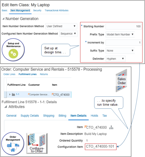

You use the Edit Item Class page in the Setup and Maintenance work area to specify the number at design time.
Order Management displays the number in the Configuration Item attribute on the sales order at runtime.
Let's say you need to add a suffix to the item name for each unique configuration of item CTO_474000. You need to start the suffix with the number 100, increment it by 1 each time a user orders the item, and use a hyphen (-) to separate the suffix from the name. For example, here's the name that the flow creates the first time the user adds the item.
CTO_474000-100
where
CTO_474000 is the name of the configured item
- (the dash) is the delimiter
100 is the starting number of your sequence
Here's the name for the next time a user adds the item.
CTO_474000-101
The number is unique across order lines, sales orders, and users.

On the Manage Item Classes page, in the search results list, search for, then open the My Laptop class for editing.
On the Edit Item Class page, click Item Management, then set the values.
Attribute
Value
Item Number Generation Method
User Defined
This means you, the administrator, defines numbering. Not the end-user who creates the sales order.
Configured Item Number Generation Method
Sequence
In the Details area, set the values.
Attribute
Value
Starting Number
100
Prefix Type
Model Item Number
Specify what displays before the starting number.
Increment By
1
Suffix Type
None
Specify what displays after the starting number.
Delimiter
Hyphen
Specify the character that separates the starting number from the prefix or the suffix.
Click Save and Close.

Click the row that contains 1-1 in the Fulfillment Line column.
In the Attributes area, click Item Details, then notice that the value of the Configuration Item attribute is CTO_474000-100.
Click the row that contains 2-1 in the Fulfillment Line column.
Notice that the value of the Configuration Item attribute is CTO_474000-101.
