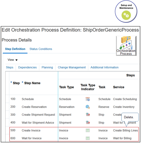

    • On the Edit Orchestration Process Definitions page, click Actions > Revise Process.
    • In the Process Details area, delete the Create Invoice step and the Wait for Invoice step.
      Page Edit Orchestration Process Definitions
