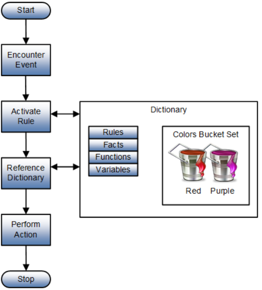

Assume you create a Colors bucket set that includes
string values of red and purple. You can write a rule for each color.
You can also write one rule for blue and another rule for purple.
