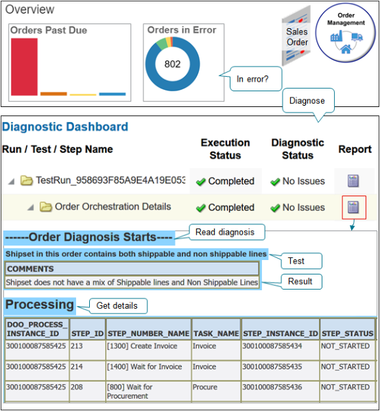

Assume you must troubleshoot sales order 385081 that you created in the Order Management work area.
Try it.
Make sure you have the privileges that you need to administer Application Diagnostics.
For details, go to Security Reference for Common Features, then see the Application Diagnostics Administrator chapter.
In the upper-right corner, click down arrow > Run Diagnostics Tests.
On the Diagnostic Dashboard page, in the Search for Tests area, enter the value, then click Search.
Attribute
Value
Test Name
Order Orchestration
In the search results, in the row that contains Order Orchestration Details in the Test Name attribute, add a check mark to the box that's left of the test name, then click Add to Run.
In the Select Tests to Run and Supply Inputs area, notice that the page added a row.
Test Name
Prerequisites
Details
Input Status
Test Identifier
No
Icon you can click
Required Input Values Are Missing
In the Input Status column, click the caution icon.
In the Input Parameters dialog, in the New Value column, click the magnifying glass.
In the Search and Select dialog, enter the value.
Attribute
Value
Source Order Number
385081
In the search results, click that row that contains your sales order, then click OK > OK.
In the Select Tests to Run and Supply Inputs area, notice the value.
Attribute
Value
Input Status
Inputs Edited: Required Input Values Validated
In the Test Run Submitted dialog, notice the text, then click OK.
Tests Run "TestRun_958693F85A9E4A19E0535EBFF20A3CA7" has been submitted
Examine the results.
In the Diagnostic Test Run Status area, click View > Refresh, then examine the values.
Attribute
Value
Run / Test / Step Name
Execution Status
Completed
Diagnostic Status
No Issues
Report
An icon you can click to get details.
Run By
Displays the user that you used to sign in, such as DIAG_ADMIN.
The refresh displays all tests that diagnostics has run in the last 24 hours.
In the Run / Test / Step Name column, expand the folder, expand the child Order Orchestration Details folder, then notice the hierarchy that displays.
TestRun_958693F85A9E4A19E0535EBFF20A3CA7 Order Orchestration Details Diagnostics_Engine_Log Order Orchestration Data -
Verify the status for each row of the hierarchy.
Attribute
Value
Execution Status
Completed
In the row that contains TestRun_958693F85A9E4A19E0535EBFF20A3CA7, in the Report column, click the icon.
The tool displays an HTML page that includes a report summary.
Close the report.
In the Diagnostic Test Run Status area, in the row that contains Order Orchestration Details, in the Report column, click the icon.

Diagnosis Area
Use the Order Diagnosis area of the report to identify problems that happened.
                         Analysis  |
                         Example Results That the Report Displays  |
                         Locked draft headers.  |
                         Sales order doesn't have a locked draft.  |
                         Fulfillment lines with null delta types.  |
                         Sales order doesn't have a null delta type.  |
                         Shipment set in this order contains shippable and nonshippable lines.  |
                         Shipment set doesn't have a mix of shippable lines and nonshippable lines.  |
                         Order fulfillment is locked because of force cancel.  |
                         There are no problems related to a forced cancellation.  |
                         Double orchestration exists for fulfillment lines in the sales order.  |
                         There are no problems related to a double orchestration.  |
                         This order has pending action requests.  |
                         All user request are done and no more changes are allowed.  |
                         No active wait record exists for this order.  |
                         There are no problems related to waits.  |
                         Previous change is pending for this order.  |
                         Order lines are healthy.  |
                         This order has hold failures.  |
                         There are no apply hold failures.  |
                         Active hold on previous change.  |
                         There are no active holds.  |

Get a Health Check
Run a test to scan through your database and identify problems across sales orders, then display a list of sales order that are in error.
Attribute
Value
Test Name
Order Management Health Check
In the Select column, add a check mark, then click Add to Run.
In the Select Tests to Run and Supply Inputs area, in the Input Status column, click the icon.
In the Input Parameters dialog, set the date range, then click OK.
Click Run.
Refresh the view until Execution Status displays Completed.
In the Order Management Health Check row, click the icon in the Report column.
Your browser displays the report in a separate tab.
Examine the results. For example:
Pending recovery for the order
Changes to sales order not successfully processed
Order lines locked by fulfillment tasks
Order lines locked by shipping tasks
Order lines that encountered problems while waiting for error recovery
Order lines that are at the Await Billing status even after being billed
Order lines that are missing references
Recover actions not available in Order Management work area but line has an error
Unstable sales orders
Performance of Order Management
