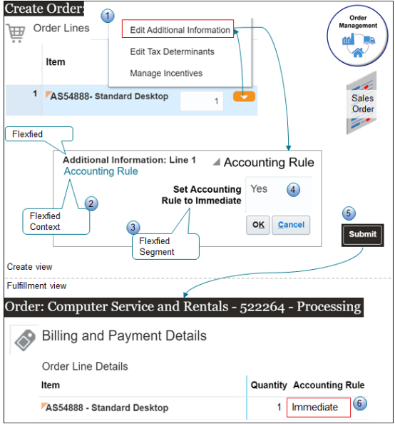

You edit the predefined Fulfillment Line Information extensible flexfield. Order Management displays it when you click Actions > Edit Additional Information on the order line.
You create a flexfield context with a display name of Account Rule. The Additional Information dialog displays the context.
You create a flexfield segment with a display name of Set Accounting Rule to Immediate. The Additional Information dialog displays the segment. The user can enter the text Yes in the segment.
You create a business rule that determines whether the segment contains the text Yes.
Order Management runs the rule when you click Submit.
If the segment contains Yes, then the rule sets the Accounting Rule attribute to Immediate.

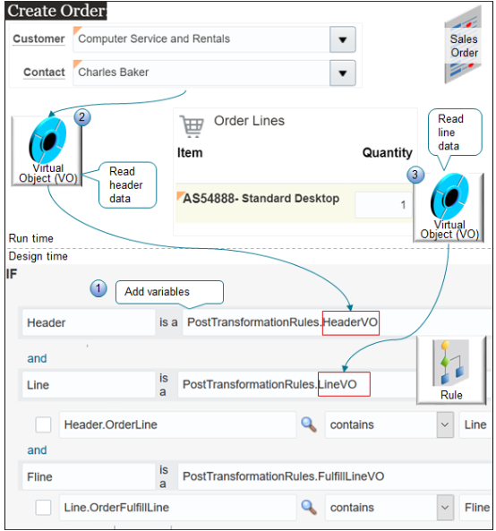

Create an If statement in your business rule, then add variables to the rule. The orchestration process uses virtual objects to read data from the sales order into these variables at run time.
You use the HeaderVO virtual object (VO) to read header data into the rule, such as values for the Customer attribute and the Contact attribute.
You use the LineVO virtual object to read order line data into the rule, such as the values for the Item attribute and the Quantity attribute.

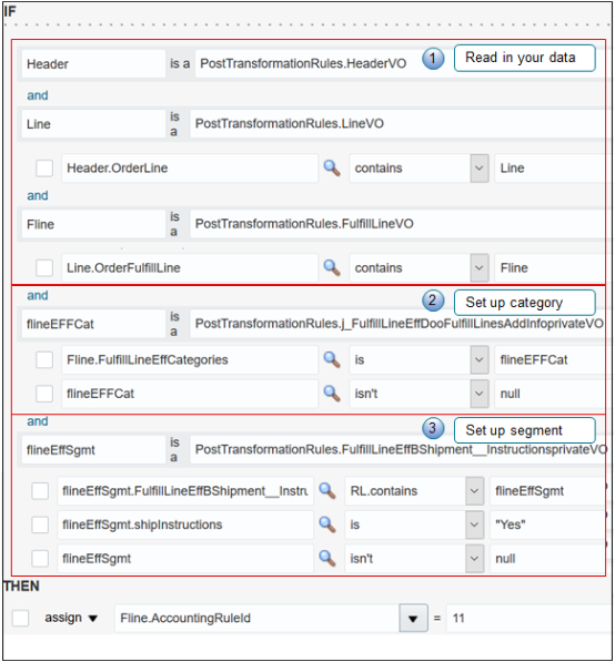

Here's an explanation of the code that you use in this example.
Code |
Description |
Declare the Header variable into the PosttransformationRules dictionary. Get values for attributes of the order header that the orchestration process is currently processing from the Header virtual object (VO), then store them in the Header variable. |
Declare the Line variable into the PosttransformationRules dictionary. Get values for attributes of the order line that the orchestration process is currently processing from the Line virtual object (VO), then store them in the Line variable. |
Declare the OrderLine variable, then place it under the Header variable. Copy the contents of the Line variable into the OrderLine variable. This code establishes the hierarchy for your flexfield. |
Declare the Fline variable into the PosttransformationRules dictionary. Get values for attributes of the order line that the orchestration process is currently processing from the FulfillLine virtual object (VO), then store them in the Fline variable. |
Declare the OrderFulfillLine variable, then place it under the Header Line. Copy the contents of the Fline variable into the OrderFulfillLine variable. This code finishes the hierarchy for your flexfield, which is.
Declare the flineEFFCat variable into the PosttransformationRules dictionary. Get values for attributes of the fulfillment line that the orchestration process is currently processing from the j_FulfillLineEffDooFulfillLinesAddInfoprivateVO virtual object (VO), then store them in the flineEFFCat variable. j_FulfillLineEffDooFulfillLinesAddInfoprivateVO is a predefined object that Order Management uses to process details for an extensible flexfield that sits on an order line. |
Use the FulfillLineEffCategories property to identify the flineEFFCat variable as a flexfield category. To establish a hierarchy, this code places the flineEFFCat variable under the Fline variable. |
Avoid a null pointer exception. Make sure the flineEFFCat variable contains a value. |
Declare the flineEffSgmt variable into the PostTransformationRules dictionary. Get values from the FulfillLineEffB Accounting_RuleprivateVO virtual object, then store them in flineEffSgmt. The business rule gets this virtual object from the order line that the orchestration process is currently processing. The business rule uses the pattern FulfillLineEffBxxxprivateVO to store details for your context code, where xxx identifies the context code that you created earlier in this procedure in the Setup and Maintenance work area. Namely, Accounting_Rule. |
Place the flineEffSgmt variable under the flineEFFCat variable. This code establishes a hierarchy between the context code and the context segment.
Examine the value of the Accounting_Rule_Segment attribute in the flineEffSgmt variable. See if it contains the text Yes. Recall that Accounting_Rule_Segment is the value that you entered for the Code attribute when you created the context segment earlier in this procedure in the Setup and Maintenance work area. |
Avoid a null pointer exception. Make sure the flineEffSgmt variable contains a value. |
Set Up the Category
Code |
Description |
Declare the flineEFFCat variable into the PosttransformationRules dictionary. Get values for attributes on the fulfillment line that the orchestration process is currently processing from the j_FulfillLineEffDooFulfillLinesAddInfoprivateVO virtual object (VO), then store them in the flineEFFCat variable. j_FulfillLineEffDooFulfillLinesAddInfoprivateVO is a predefined object that Order Management uses to process details for an extensible flexfield that sits on an order line. |
Use the FulfillLineEffCategories property to identify the flineEFFCat variable as a flexfield category. To establish a hierarchy, place the flineEFFCat variable under the Fline variable. |
Set Up the Segment
Code |
Description |
Create the Then statement.
Code |
Description |
The AccountingRuleId has a set of numeric values. Each value represents an accounting rule. The value 11 represents Immediate. |

3. Test Your Setup
Go to the Order Management work area, create a sales order, and add an order line.
On the order line, click the Actions down arrow, then click Edit Additional Information.
Click Accounting Rule.
In the text box that's labeled Set Accounting Rule to Immediate, enter the text
Yes. -
Click Submit.
On the Order page, click Billing and Payment Details.
In the Order Line Details area, click View > Columns > Accounting Rule.
Examine the order line and verify that the Accounting Rule attribute contains Immediate.
