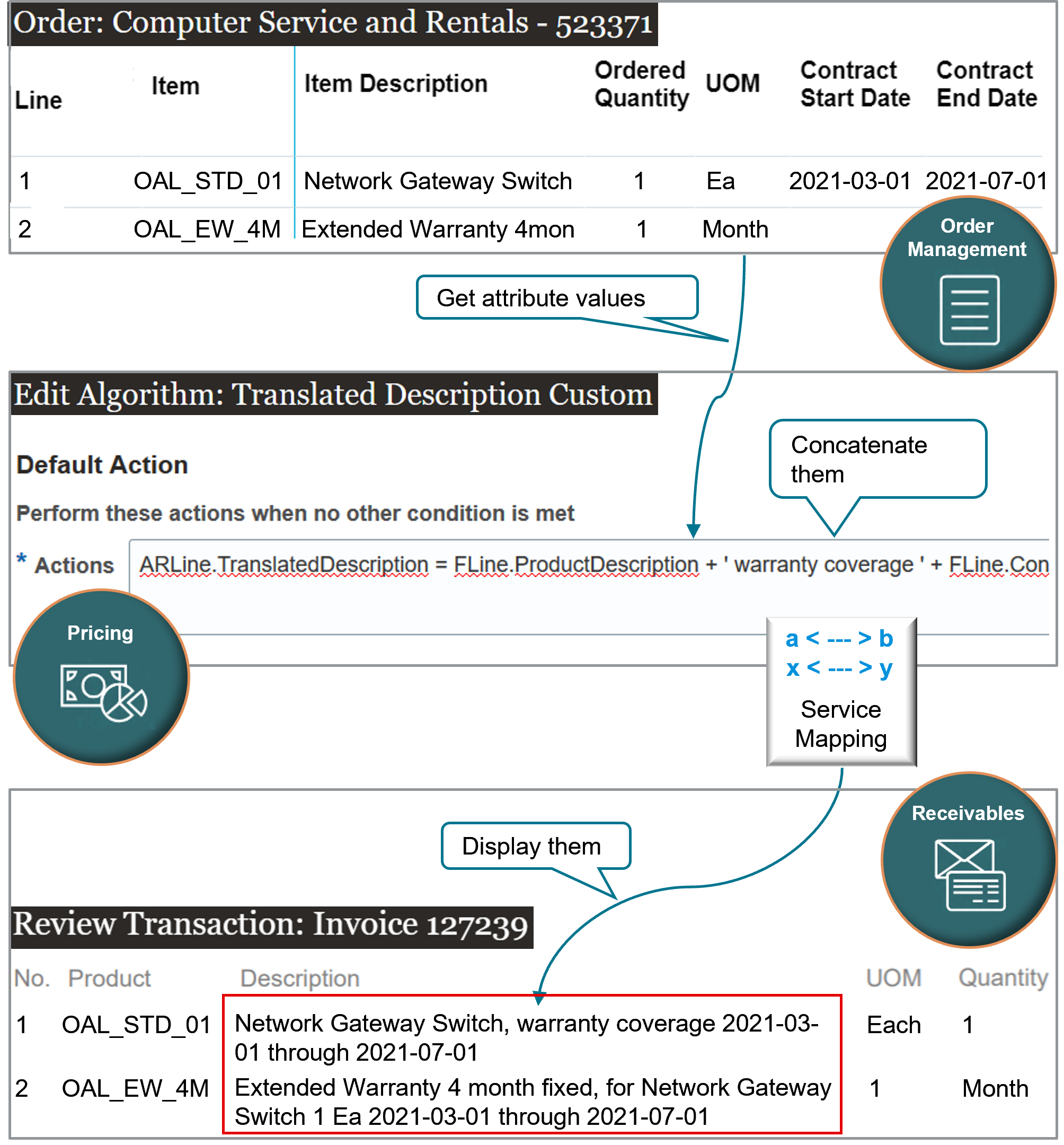

Use an integration algorithm to implement specialized behavior when you integrate Order Management.
Here's an example.
      Note
            You get attributes value on the fulfillment line from Order Management, including the Item Description, Quantity, Unit of Measure, Contract Start Date, and Contract End Date.
            You use an integration algorithm in the Pricing Administration work area to concatenate the values for the attributes into a single string of text, and then use a service mapping to map it to Oracle Receivables.
            The Description on the invoice in Oracle Receivables displays the string.
            If the sales order contains a coverage item, such as a warranty, then you create another concatenated string for the description of the coverage item. This string includes the description of the coverage item plus the same attribute values that the string for the covered line has.
Your mapping requirement is too complex to meet with only a service mapping, so you set up an integration algorithm that creates the concatenated string and gets the data you'll need from the order line that has the covered item.

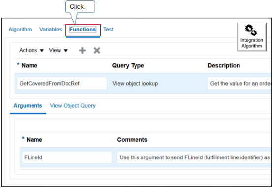

               Add a function. -
                     Click Functions, click Actions > Add Row, then set the values. Attribute Value Name GetCoveredFromDocRef Query Type View Object Lookup Description Get the value that identifies the order line that has the covered item.
                     In the Arguments area, click Add Row, then add an argument. Attribute Value Name FLineId Comments Use this argument to send the FLineId (fulfillment line identifier) that identifies the fulfillment line that contains the coverage item, and then return a value that identifies the covered item.
                     Click View Object Query, then add a new query. Attribute Value Application Module oracle.apps.scm.doo.common.process.model.applicationModule. DooExtensibleMapperAM This is a predefined value. You must not use any other value. Application Configuration DooExtensibleMapperAMLocal This is a predefined value. You must not use any other value. View Object DocumentReferenceVO This view object contains mapping values from coverage item and the covered item. View Criteria getCoveredLine The getCoveredLine view criteria on the DocumentReferenceVO view object helps the algorithm identify the fulfillment line that has the covered item. Single Row Contains a check mark.
                     In the Bind Variables area, create a new bind variable. Attribute Value Bind Variable Name flineId Bind Variable Value FLineId
                     Click Save.

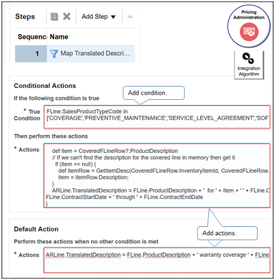

               In the Execute Condition area, click Add Condition > Default Action. You will add the code that creates the concatenated string for the covered item. In the Default Action area, add code in the Actions window. ARLine.TranslatedDescription = FLine.ProductDescription + ' warranty coverage ' + FLine.ContractStartDate + ' through ' + FLine.ContractEndDatewhere Code What it Does ARLine.TranslatedDescription =Create a variable named TranslatedDescription and add it to the ARLine data set. Store the value of the concatenated string in the TranslatedDescription variable. FLine.ProductDescriptionGet the value of the description for the fulfillment line that we're currently processing. This is the description for the covered item from the FLine data set. FLine.ContractStartDateGet the value of the contract start date for the covered item from the FLine data set. If you add coverage to a covered item, then you use the Contract Start Date and Contract End Date on the covered item, not the coverage item. The coverage item provides coverage for a duration, such as 1 Year, but not for the specific start date and end date. Instead, you set the start date and end date on the covered item. This way, you can use the coverage item for a variety of covered items. FLine.ContractEndDateGet the value of the contract end date for the covered item from the FLine data set. + ' ' +Concatenate the value of one string to another. Insert a space between these concatenated strings. + ' warranty coverage ' ++ ' through ' +Concatenate the value of one string to another. Insert text between these concatenated strings. For example, insert the phrase warranty coveragebetween these concatenated strings.This action applies to fulfillment lines that contain a standard item or shippable item. This code specifies how to concatenate the attribute values. Here's an example of the run time value that this code renders. Network Gateway Switch, warranty coverage 2021-03-01 through 2021-07-01
               Add the code that creates the concatenated string for the coverage item. You will add a new conditional action that applies only if the item is a coverage item. The concatenation is slightly different for a coverage item than it is for a covered item. You also need to get some details from the line that has the covered item. -
                     In the Execute Condition area, click Add Condition > True Condition.
                     In the Conditional Actions area, add code in the True Condition window. FLine.SalesProductTypeCode in ['COVERAGE','PREVENTIVE_MAINTENANCE','SERVICE_LEVEL_AGREEMENT','SOFTWARE_MAINTENANCE','INCLUDED_WARRANTY']The SalesProductTypeCode attribute on the fulfillment line specifies whether the line contains a coverage item, such as a maintenance agreement, warranty, and so on. So this code specifies to do this conditional action only if the line contains a coverage item.
                     Add code in the Actions window. CoveredFlineDocRefRow = GetCoveredFromDocRef(FLine.FulfillLineId) if (CoveredFlineDocRefRow?.DocSublineId != null) { // Locate the covered line according to DocSublineId CoveredFLineRow = AllFLines.locate([FulfillLineId: Long.parseLong(CoveredFlineDocRefRow?.DocSublineId)]) // If we can't find the covered line in memory then get it if (CoveredFLineRow == null) CoveredFLineRow = GetCoveredFLine(CoveredFlineDocRefRow?.DocSublineId) def item = CoveredFLineRow?.ProductDescription // If we can't find the description for the covered line in memory then get it if (item == null) { def itemRow = GetItemDesc(CoveredFLineRow.InventoryItemId, CoveredFLineRow.InventoryOrganizationId) item = itemRow.Description; } ARLine.TranslatedDescription = FLine.ProductDescription + ' for ' + item + ' ' + FLine.OrderedQty.toString() + ' ' + FLine.OrderedUom + ' ' + FLine.ContractStartDate + ' through ' + FLine.ContractEndDate }where Code Description CoveredFlineDocRefRow = GetCoveredFromDocRef(FLine.FulfillLineId)Use the GetCoveredFromDocRef function that you created earlier on the algorithm to get the value the identifies the fulfillment line that contains the covered item. Store the value in the CoveredFlineDocRefRow variable that you created earlier on the algorithm. if (CoveredFlineDocRefRow?.DocSublineId!=null)Ask whether DocSublineIdcontains a value. If it does contain a value, then it means the sales order contains a covered line and we need to process it.CoveredFLineRow = AllFLines.locate([FulfillLineId: Long.parseLong(CoveredFlineDocRefRow?.DocSublineId)])Set the value of the CoveredFLineRow attribute that you created earlier on the algorithm to the fulfillment line that contains the covered item. CoveredFlineDocRefRow?.DocSublineIdmeans to get this value from theDocSublineIdattribute of the AllFLines data set.if (CoveredFLineRow == null) CoveredFLineRow = GetCoveredFLine(CoveredFlineDocRefRow?.DocSublineId)If we can't find the covered line in memory then get it. Use the DocSublineIdattribute with the GetCoveredFLine function that you created earlier to find it, then use the results to set the value for CoveredFLineRow to the line that contains the covered item.def item = CoveredFLineRow?.ProductDescriptionDefine a variable named itemand set its value to the contents of the ProductDescription attribute. Get the value of ProductDescription from the fulfillment line that CoveredFLineRow identifies.if (item == null){ def itemRow = GetItemDesc(CoveredFLineRow.InventoryItemId, CoveredFLineRow.InventoryOrganizationId) item = itemRow.Description; }If your itemvariable is empty, then it means we still need to find the description for the covered line in memory.Define a variable named itemRow. Use the GetItemDesc method that you added earlier to the algorithm to get the values of the InventoryItemId attribute and the InventoryOrganizationId attribute from the fulfillment line that CoveredFLineRow contains. Use these values to verify that the row contains the item, then set the value of itemRow to this fulfillment line. Set the itemvariable to the value of the Description on the fulfillment line that itemRow identifies.ARLine.TranslatedDescription = FLine.ProductDescription + ' for ' + item + ' ' + FLine.OrderedQty.toString() + ' ' + FLine.OrderedUom + ' ' + FLine.ContractStartDate + ' through ' + FLine.ContractEndDateCreate a variable named TranslatedDescription and add it to the ARLine data set. Store the value of the concatenated string in TranslatedDescription. FLine contains attribute values for the line that we're currently processing, which is the coverage item. -
                                          FLine.ProductDescriptionis the description of the coverage item.
                                          itemis a variable that contains the description of the covered item, such as Desktop Computer.
                                          FLine.OrderedQty.toString()is the quantity of the coverage item, converted to a string.
                                          FLine.ContractStartDateis the start date of the coverage item.
                                          FLine.ContractEndDateis the end date of the coverage item.
 This description is going on the invoice line that has the coverage item, so its useful to identify the item that the coverage covers. Here's an example of the run time value that this code renders. Extended Warranty 4 month fixed, for Network Gateway Switch 1 Ea 2021-03-01 through 2021-07-01
