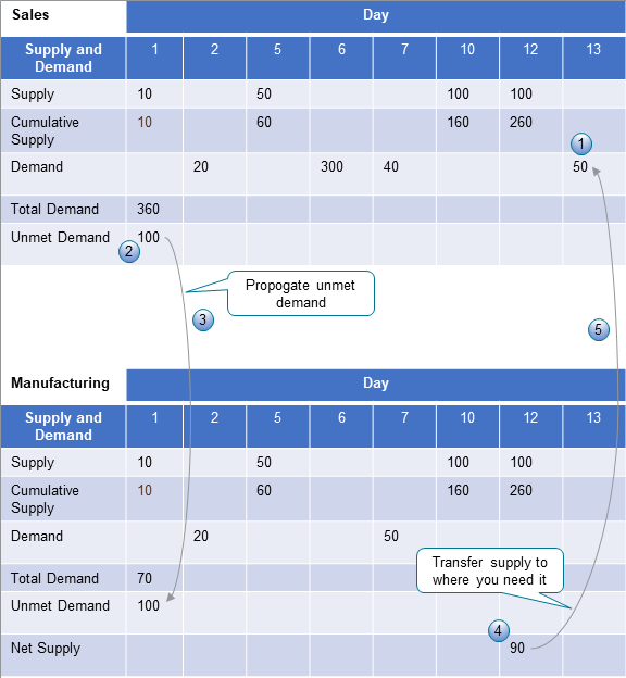

Assume you sell the AS54888 desktop item, and you keep supply for it in Sales and in Manufacturing. The supply for Sales and Manufacturing is:
  • 10 units on day 1
  • 50 units on day 5
  • 100 units on Day 10
  • 100 units on day 12
So, Sales and Manufacturing each have a total supply of 260 units.
What the Numbers Mean
  1. You receive new demand of 50 units on day 13 for the item in Sales.
  2. Assume Promising already promised some supply to fulfill previous sales orders for 20 units, 300 units, and 40 units, for a total demand quantity of 360 units. So, the total quantity of unmet demand in Sales is 100 units (360 minus 260).
  3. Promising propagates the unmet demand to Manufacturing, according to how you set up your sourcing rules. For this example, assume it propagates all of 100 from Sales to Manufacturing.
  4. The incoming supply for Manufacturing is 260 units, with demand in Manufacturing of 70 units. The total demand including unmet demand that Promising propagates from Sales to Manufacturing is 170 units. So, the net supply that Promising can use to promise new sales orders on day 12 in Manufacturing is 90 units (260 minus 170).
  5. Promising transfers the supply quantity that it needs to promise the item from Manufacturing to Sales.
