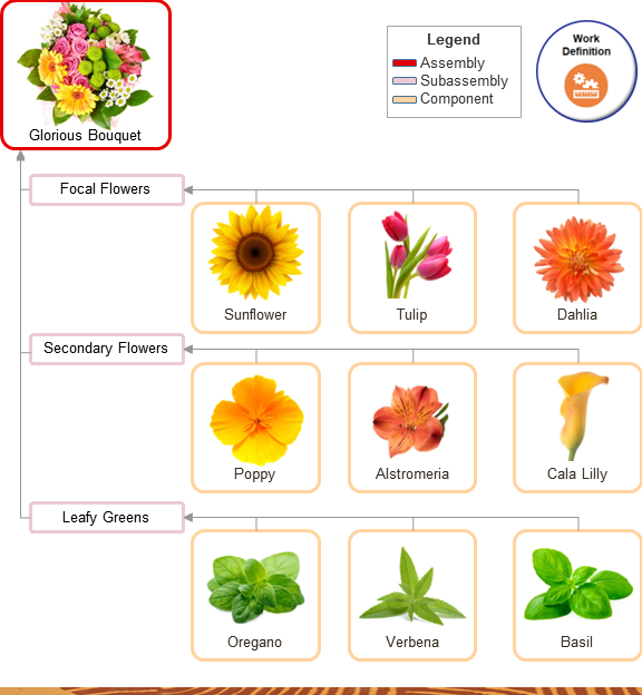

In some business scenarios, you might need to have a lot of flexibility in your work definition.
Assume you sell an item named Glorious Bouquet, which is a bouquet of flowers. Your customers have very discerning tastes about what flowers they want to see in various parts of the bouquet, at different times of the year. Some types of flowers are always available and your customers always want them, regardless of season, so you consider them to be fixed. However, other flowers come and go with the season, so you view them as variable.
Assume your work definition has this hierarchy:
where
- Glorious Bouquet is your top level assembly.
- Focal Flowers, Secondary Flowers, and Leafy Greens are subassemblies.
- Sunflower, Tulip, Dahlia, California Poppy, Alstroemeria, Cala Lilly, Oregano, Verbena, and Basil are components.
For brevity, we'll focus on Secondary Flowers and California Poppy. Here's how we identify them:
| Item | Description |
| Glorious Bouquet | AS301. Top level assembly. |
| Secondary Flowers | SA1. A subassembly that contains components. |
| California Poppy | C1. A component. |
Assume your work definition contains more than one instance of the same critical component at different levels in the work definition, and the component's basis is different depending on the effective date. The scheduled process will link each instance to the parent item. If the component's basis is:
- Fixed. The scheduled process will roll up the dates for each instance to the parent.
- Variable. If the dates between the subassembly and the component match, or if the component's dates are within the subassembly's dates, then the bill of resources will include that component. If not, then it won't include that component. This logic applies when you have a subassembly that isn't critical and it contains a component that is critical.
You need to prepare for the upcoming Summer and Fall bouquet selling season, which runs July 21 through December 1. You need to promise differently depending on some seasonal variation in supply, so you create this work definition:
| Row | Description | Assembly | Subassembly or Component | Effective Date | Quantity | Basis | Find Number |
| 1 | Glorious Bouquet | AS301 | SA2 | July 21 | 1 | Fixed | 1 |
| 2 | Secondary Flowers | - | SA2 | July 21 through September 30 | 5 | Variable | 2 |
| 3 | Secondary Flowers | - | SA2 | July 21 through November 1 | 6 | Variable | - |
| 4 | Secondary Flowers | - | SA2 | November 2 | 10 | Variable | - |
| 5 | California Poppy | SA2 | C1 | July 21 through December 1 | 1 | Fixed | 1 |
| 6 | California Poppy | - | C1 | August 1 through October 1 | 2 | Fixed | 2 |
| 7 | California Poppy | - | C1 | July 21 through November 1 | 2 | Variable | - |
Note that if there's no end date, then the Effective Date column in the table includes only the start date.
You create more than one instance of the Secondary Flowers subassembly in the Glorious Bouquet assembly to account for seasonal variations:
- Row 1. Contains Glorious Bouquet, your top level assembly. The dates run for the full duration of the selling season, July 21 through September 30.
- Row 2. Contains Secondary Flowers with July 21 through September 30 and a quantity of 5 to cover the early part of the selling season.
- Row 3. Contains Secondary Flowers with July 21 through November 1 and a quantity of 6 to pick up an increase in the supply that's typically available later in the season.
- Row 4. Vast batches of secondary flowers become available during the Fall harvest at the end of October, you know you'll have a surplus inventory of secondary flowers, so you create this instance of Secondary Flowers with a much larger quantity of 10, and you put it into effect on November 2.
- Row 5. The California Poppy is your trademark secondary flower, you always include at least one of them, so you add it as fixed, with a quantity of 1, July 21 through December 1. This covers most of the selling season.
- Row 6. You add the poppy with a quantity of 2, August 1 through October 1.
- Row 7. More poppies are available between August and November than they are July through December, so you increase the number of poppies that you include in your bouquet August through November.
Note
- The work definition specifies the Find Number attribute for Secondary Flowers and California Poppy.
- Assume all components and resources are critical except for SA2, Secondary Flowers.
- We're using "rows" here only to help describe the example. There's no such row in your actual work definition.
If the California Poppy has a variable basis, and if that poppy's date range:
- Matches or falls within Secondary Flowers' date range. The scheduled process will roll up that poppy's date range.
- Doesn't match or fall within Secondary Flowers' date range. The bill of resources won't include that poppy.
Assume you run the Create Bills of Resources scheduled process on July 20. The scheduled process will create this bill of resources:
| Assembly | Component | Effective Date | Quantity | Basis | Find Number |
| Glorious Bouquet, AS301 | California Poppy, C1 | July 30 through December 1 | 1 | Fixed | 1 |
| - | California Poppy, C1 | August 1 through October 1 | 2 | Fixed | 2 |
| - | California Poppy, C1 | July 21 through November 1 | 12 | Variable | - |
The bill of resources will include the C1 from these rows of the work definition:
- Row 5 because its basis is fixed. The bill of resources will include all fixed components. It will also include the exact quantity for each fixed component from the work definition. It doesn't adjust the quantity because the quantity is also fixed, not variable.
- Row 6 because its basis is fixed.
- Row 7 because the date range for the C1 poppy in row 7 is July 21 through November 1, and that date range matches the range for the SA2 Secondary Flowers that's in row 3.
Here's the math that the scheduled process applies to get a quantity of 12 poppies:
- Row 3 in the work definition has a quantity of 6, which means the Glorious Bouquet needs 6 Secondary Flowers subassemblies.
- Row 7 for the C1 California Poppy has a quantity of 2, so each Secondary Flowers subassembly on row 3 needs a quantity of 2 C1 California Poppy components.
- 2 California Poppy components multiplied by 6 Secondary Flowers subassemblies equals 12 poppies. That quantity also happens to be enough poppies to line each side of the yellow brick road.

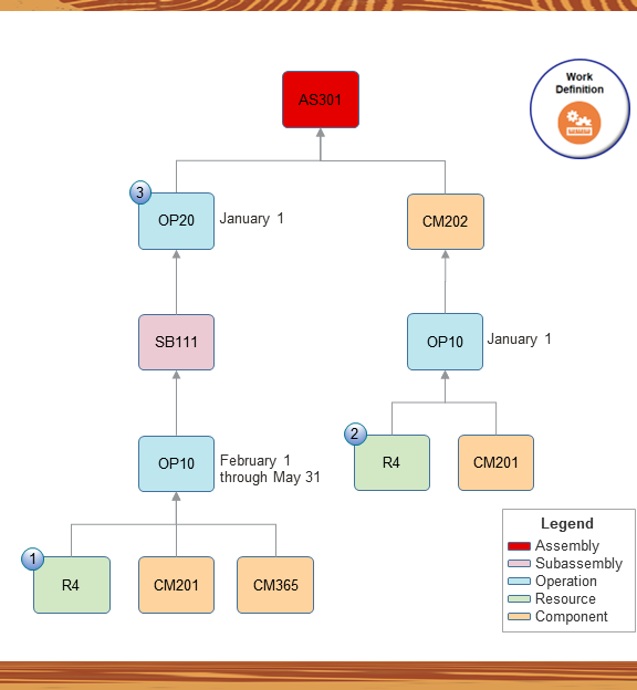

Now let's assume your work definition has a slightly different hierarchy:
M1
  AS301
    CM201
    CM202
    R3
    R4
    SB111
      CM201
      CM365
      R4
Assume you have these values.
| Assembly | Component or Resource | Operation Sequence | Quantity | Basis | Effective Date |
| AS301 | CM202 | 10 | 1 | Variable | January 1 |
| - | CM201 | 10 | 1 | Variable | January 1 |
| - | R4 | 10 | 0.5 | Variable | January 1 |
| - | SB111 | 20 | 1 | Variable | January 1 |
| - | R3 | 20 | 0.5 | Variable | January 1 |
| SB111 | CM201 | 10 | 1 | Variable | February 1 through May 31 |
| - | CM365 | 10 | 1 | Variable | February 1 through May 31 |
| - | R4 | 10 | 0.5 | Variable | February 1 through May 31 |
Assume:
- All components and resources are critical except for SB111 and R3.
- The AS301 and SB111 both use the same CM201 component and the same R4 resource.
- The CM201 goes into effect on January 1 with no end date, and the R4's date range is February 1 through May 31, so the dates for CM201 and R4 overlap each other.
Assume you run the Create Bills of Resources scheduled process on January 1, and it creates this bill of resources:
| Assembly | Component or Resource | Quantity | Effective Date |
| AS301 | CM202 | 1 | January 1 |
| - | CM201 | 1 | January 1 |
| - | CM201 | 1 | February 1 through May 31 |
| - | R4 | 0.5 | January 1 |
| - | CM365 | 1 | February 1 through May 31 |
| - | R4 | 0.5 | February 1 through May 31 |
The scheduled process will roll up child SB111's components, resources, and dates to the parent AS301 in the bill of resources.
If demand for the CM202 component happens:
- February 1 through May 31, Promising will consume a quantity of 2
- January 1 through January 31, or on or after June 1, Promising will consume a quantity of 1
If demand for the R4 resource happens:
- February 1 through May 31, Promising will consume a quantity of 1 hour
- January 1 through January 31, or on or after June 1, Promising will consume a quantity of 0.5 hours
Note that you set the item's basis to Fixed or Variable.
This example will you give you a work definition with this hierarchy after you finish collecting data:
Note
- The R4 resource will do the OP10 operation to build the SB111 subassembly. It will use the CM201 and CM365 components. This OP10 can start as early as February 1 but must end no later than May 31.
- The R4 resource will do the OP10 operation and will use the CM201 component to assemble the CM202 component. This OP10 can start anytime on or after January 1.
- The R4 resource will do the OP20 operation to build the final AS301 assembly. It will use the SB111 subassembly and the CM202 component. This OP20 can start anytime on or after January 1.
