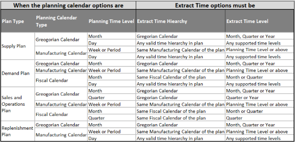

The extract time hierarchy depends on the plan type, the planning calendar associated with the plan, and the planning time level. Validation rules apply for the Extract Time Hierarchy field, based on the type of plan.

The extract time level depends on the plan type, the planning calendar associated with the plan, and the planning time level. The Extract Time Level selection is subject to validation for each plan type.
Plan Type |
Rule |
Supply plan |
Largest supply planning bucket or above. For example:
Demand plan |
Planning time level of the plan or above. |
Demand and Supply plan |
Sales and Operations plans |
Replenishment plan |
