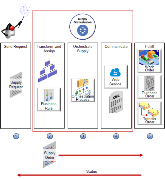

How Supply Chain Orchestration Works
Supply Chain Orchestration uses orchestration processes and web services to create and manage supply.
Send request. An application sends a request to Supply Chain Orchestration to create supply.

Transform and assign request. Transform the supply request to a supply order. Run predefined rules or rules that you create.

Assign a predefined orchestration process to the supply order. Supply Chain Orchestration uses different orchestration processes to manage supply. Each process optimizes processing according to the type of flow, such as a make flow.
Use a scheduled process to periodically run each orchestration process. For details, see Use Composites to Plan Supply.
Orchestrate supply order. The orchestration process contains steps that create supply and do fulfillment tasks. For example, the process might call a manufacturing system to create or modify a manufacturing work order, or a purchasing system to create or change the quantity on a purchase order.

Communicate. The flow calls a web service and uses it to send and receive messages to and from each fulfillment system.
Create an XML payload that's specific to each fulfillment system, then send it to the fulfillment system.
Receive updates from the fulfillment system and send them to the orchestration process for change management. For example, receive and send a status change or quantity decrease on a purchase order.
Fulfill. The fulfillment system uses supply to create and fulfill the item. For example:

Supply Chain Orchestration communicates status to the application that requests supply during fulfillment.
