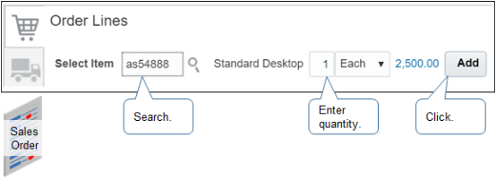

In the Order Lines section, in the Select Item attribute, enter text or enter a number that identifies the item your customer is ordering, press TAB on your keyboard, wait for Order Management to display item details, and then click Add.
Here's how you add the AS54888 item:
