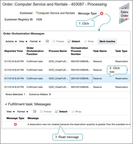

Assume you submit an order line that includes a quantity of 20, but inventory only has an on-hand quantity of 10. You open the sales order in a fulfillment view, click the icon next to Message Type in the order header, then notice the messages.
The Order Orchestration Messages dialog displays a message for the Reservation step of the orchestration process
The Order Orchestration Messages dialog displays a message for the Reservation step of the orchestration process.
Orchestration couldn't create a reservation because the reservation quantity is greater than the available-to-reserve quantity.
This error might happen when you create a sales order, change the quantity when you revise the order, or add a new order line to an order that already exists. You can reduce the ordered quantity on the order line to 15 and submit a revision, or inventory can increase the on-hand quantity and you can recover the order line. The orchestration process will then send another reservation request, inventory processes the line, and the line moves to the next orchestration process step.
