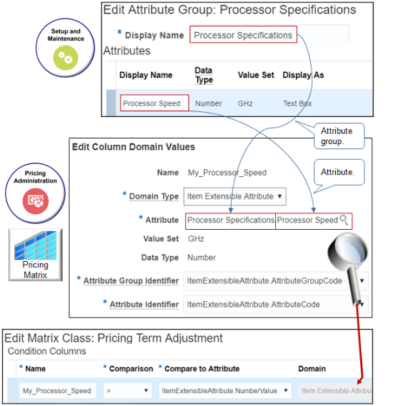

Vision Corporation sells a microprocessor item and provides a discount according to processor speed. You can create an item extensible attribute named Processor Speed, and set up a discount for the microprocessors that run at 1.1 GHz.
Note
Use the Setup and Maintenance work area to create an item extensible attribute named Processor Speed, and to add it to the Processor Specifications attribute group.
Use the Pricing Administration work area to create a pricing term adjustment that references the Processor Speed attribute.
Use the Domain to reference Processor Speed.
Here's the format that the Domain column uses.
attribute_group_identifier.attribute_identifier:attribute_group.attribute_name. = default_value

attribute_group_identifierspecifies the attribute of the service data object to use when comparing against the attribute group code. -
attribute_identifierspecifies the attribute of the service data object to use when comparing against the attribute code.
Note
AttributeGroupCode specifies to use the Processor Specifications attribute group when comparing against the attribute group code.
AttributeCode specifies to use the Processor Speed attribute when comparing against the attribute code.

Edit the Matrix Class
Edit the matrix class so you can reference it from a rule in a discount list. For details, see Pricing Matrix Class.
Go to the Pricing Administration work area, then click Tasks > Manage Matrix Classes.
On the Manage Matrix Classes page, click Pricing Term Adjustment.
On the Edit Matrix Class page, in the Condition Columns area, click Actions > Add Row, then set the values.
Attribute
Value
Name
My_Processor_Speed
Source Code Name
Accept the default value.
Comparison
= (equals sign)
Compare to Attribute
Select an attribute. For this example, processor speed is a Number data type, so select
itemExtensibleAttribute.NumberValue.Make sure you select the same data type that you specify when you set up the attribute on the Manage Item Attribute Groups and Attributes page. If these data types don't match, then Pricing can't calculate the price.
You can select only one of these values.
itemExtensibleAttribute.AttributeGroupCode
itemExtensibleAttribute.AttributeCode
itemExtensibleAttribute.VarCharValue
itemExtensibleAttribute.DateValue
itemExtensibleAttribute.TimeStampValue
Set the domain.
In the Domain column, click Edit Domain.
In the Edit Column Domain Values dialog, set the value.
Attribute
Value
Domain Type
Item Extensible Attribute
In the Attribute field, click the magnifying glass.
In the Search and Select dialog, set the value, then click Search.
Attribute
Value
Attribute Name
Processor
Pricing uses the attribute you specify in the input SDO (service data object) of the service mapping. For details, see How Service Mappings, Pricing Algorithms, and Matrixes Work Together.
Note
The Search and Select dialog gets the attributes that it displays from the Manage Item Attribute Groups and Attributes page. You can search on any text as long as it matches the attributes that you define on this page.
For example, if the Processor Specifications attribute group in the Manage Item Attribute Groups and Attributes page contains the Processor Speed attribute, then you can search Attribute Group for Processor Specifications.
Only some of the attributes from the Manage Item Attribute Groups and Attributes page are useful for Pricing. For example, it might contain several thousand attributes for processors for use in different contexts. You can use the attribute group to help filter the search results so they're specific to Pricing.
In the search results, select the attribute that your pricing matrix must reference, such as Processor Speed, then click OK.
Here's the dot notation that the Attribute field uses to indicate your choice.
Attribute_group_name.attribute_name
For example:
Processor Specifications.Processor Speed

Attribute Group Identifier
ItemExtensibleAttribute.AttributeGroupCode
Attribute Identifier
ItemExtensibleAttribute.AttributeCode
Set the value, then click OK.
