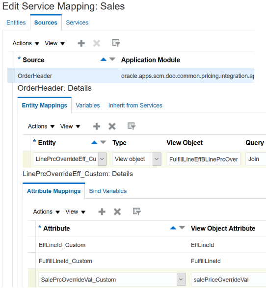

Set up the source for the order header.
Click Sources, then click the row that includes the value.
Attribute
Value
Source
OrderHeader
On the Entity Mapping tab, click View > Columns, then add a check mark to Joined Entity and Joined Entity Attribute.
Click Actions > Add Row, set the values, then click Save.
Attribute
Value
Entity
LinePrcOverrideEff_Custom
Type
View Object
View Object
FulfillLineEffBLinePrcOverrideprivateVO
Make sure the value you enter matches exactly the value you noticed earlier in this topic when you examined the flexfield archive. Don't include the
.xmlextension.Query Type
Join
Query Attribute
FulfillLineId
Joined Entity
Line
It might be necessary to click another row, and then return to this row to get the joined entity attributes to populate values.
LineId
In Details area LinePrcOverrideEff_Custom, add the attributes, then click Save.
Attribute
View Object Attribute
EffLineId_Custom
EffLineId
FulfillLineId_Custom
FulfillLineId
SalePrcOverrideVal_Custom
salePriceOverrideVal
Make sure the value you enter matches exactly the value you noticed in tag ViewAttribute Name of the flexfield archive you examined earlier in this topic. For example,
ViewAttribute Name="salePriceOverrideVal".This step sets up Pricing to read extensible flexfield values from the public view object that Order Management sends to Pricing when the Order Entry Specialist uses the Price Order action or saves the sales order.
For example:

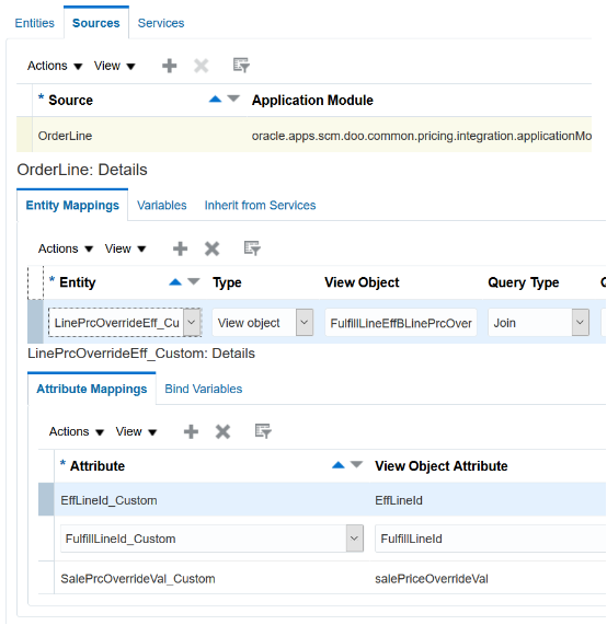

Set up the source for the order line.
In the Sources area, click the row that includes the value.
Attribute
Value
Source
OrderLine
On the Entity Mapping tab, click Actions > Add Row, set the values, then click Save.
Attribute
Value
Entity
Type
View Object
View Object
Query Type
Join
Query Attribute
FulfillLineId
Joined Entity
Line
LineId
This step maps the extensible flexfield attributes in the public view object. It sets up Pricing to read extensible flexfield values from the public view object that Order Management sends to Pricing when Order Management updates the line quantity or shipping attributes on the order line.
In the Details area for HeaderPricingEff_Custom, add the attributes.
Attribute
EffLineId_Custom
EffLineId
FulfillLineId
Make sure the value you enter matches exactly the value you noticed in the ViewAttribute Name tag of the flexfield archive you examined earlier in this topic. For example,
ViewAttribute Name="salePriceOverrideVal".This step sets up Pricing to read extensible flexfield values from the public view object that Order Management sends to Pricing when Order Management updates the quantity attribute or a shipping attribute on the order line.
For example:

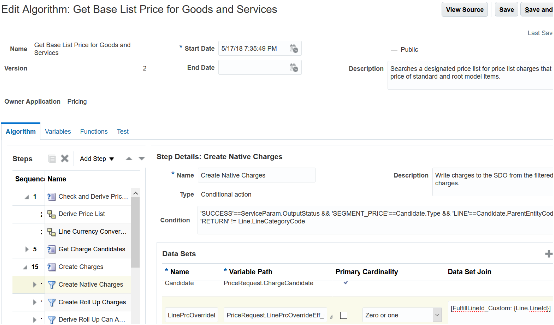

On the Edit Algorithm page, on the Algorithm tab, expand step Create Charges, then click step Create Native Charges.
You will modify this step so it references the extensible flexfield that contains the override value.
In the Data Sets area, add this data set.
Attribute
Value
Name
LinePrcOverrideEff
Variable Path
PriceRequest.LinePrcOverrideEff_Custom
Cardinality
Zero or one
Data Set Join
[FulfillLineId_Custom: {Line.LineId}]
For example:
