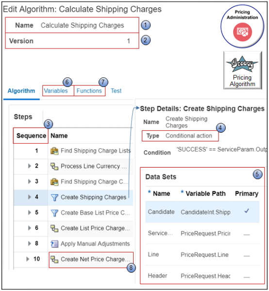

Parts of a Pricing Algorithm
A pricing algorithm manipulates data in the output service data object (SDO) that Pricing uses to calculate price, such as adding a value to each attribute in the SDO.
Here are the parts of a typical pricing algorithm.
Note
  1. Name. Each pricing algorithm achieves a finite goal, such as determining the shipping charge list to use when calculating the shipping charge, and creating the shipping charges for each order line that requires a shipping charge calculation.
  2. Version. Pricing increments the version of the pricing algorithm each time you publish it.
  3. Sequence. A series of steps that the pricing algorithm processes in a sequence. You can move each step up or down to modify the sequence.
    Assume a tax authority requires that you calculate tax only on the item that you are selling, and not on the shipping charge. You can move Step 10, Compute Tax, to immediately above Step 4, Create Shipping Charges.
  4. Step Type. Click the step, then use the Step Details area to modify the step.
    The Type specifies the type of logic that the step uses, such as Conditional Action, Nested Action, Group, or Subalgorithm.
    Step 4, Create Shipping Charges, is a conditional step that writes shipping charges to the output SDO only if the order line is a candidate for a shipping charge. Here's the condition it uses.
    Condition
    Description
    'SUCCESS' == ServiceParam.OutputStatus && 'LINE' == Candidate.ParentEntityCode
    Run this step only if the order line is a candidate for a shipping charge.
    Here's the format that the condition uses.
    • SUCCESS
    • ServiceParam. Identifies a data set in this pricing algorithm step.
    • OutputStatus.
    • LINE.
    • Candidate. Identifies a data set in the pricing algorithm step.
    • ParentEntityCode.
    For details, see Manage Pricing Algorithm Steps.
  5. Data Sets. Each row in the Data Sets area defines a data set, and each data set filters the set of records that the step processes.
  6. Variables. Set up variables that the pricing algorithm uses. For example, if you set the NeedsCurrencyConversion variable to Yes in the Calculate Shipping Charges algorithm, then each algorithm step that involves currency will do a conversion.
  7. Functions. Set up functions that receive data from the algorithm, process it, then return one or more values to the algorithm.
  8. Subalgorithm. Another pricing algorithm that this pricing algorithm references.
    Step 10 of the Calculate Shipping Charges algorithm references the Create Net Price Charge Component subalgorithm. At runtime, Pricing runs the subalgorithm, then returns to the subsequent step. It returns to step 11.

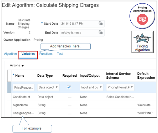

Variables
A variable in a pricing algorithm stores a value that can change depending on conditions or details that pass through each algorithm step. Use it to receive data from the object that calls the pricing algorithm, or to send data to the object.
Here are the attributes you can use with a variable.
Attributes
Description
Name
Alphanumeric text that describes the variable. Use a name that's unique in the algorithm.
Don't include spaces.
Data Type
Data type, such as String.
If you set Data Type to Data Object, then you must set a value in the Internal Service Schema attribute.
Required
Add a check mark to make this variable required in an algorithm step.
Input/Output
Specify usage.
  • Input. The object that calls this pricing algorithm can send the value of this variable to the pricing algorithm.
  • Output. The algorithm can send the value of this variable to the object that calls this pricing algorithm.
If you set the Data Type variable to Data Object, then set Internal Service Schema to the service that provides details to this variable, or that can use the output that this variable provides.
For example, the CalculateSalesOrderTotals service calculates the total price of a sales order. If you must use this variable to calculate total price, then set Internal Service Schema to CalculateSalesOrderTotals.
Most algorithms include at least one Data Object variable.
Default Expression
Groovy expression that specifies the default value for the variable. If the input payload results in setting the value of the variable to a value that isn't empty, then Pricing ignores the expression.
You can use an expression for each data type except Data Object.

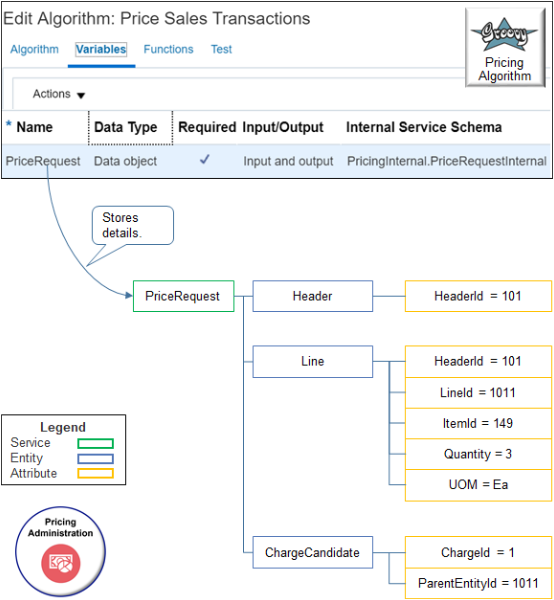

Most algorithms include the PriceRequest variable. It stores details for the PriceRequest service data object according to the transaction you must price, such as a sales order.
Note
  • PriceRequest uses the PricingInternal.PriceRequestInternal internal service schema.
  • PriceRequest stores details for the Header, Line, and ChargeCandidate entities.
  • Pricing creates the ChargeCandidate from the segment price list on the pricing strategy.

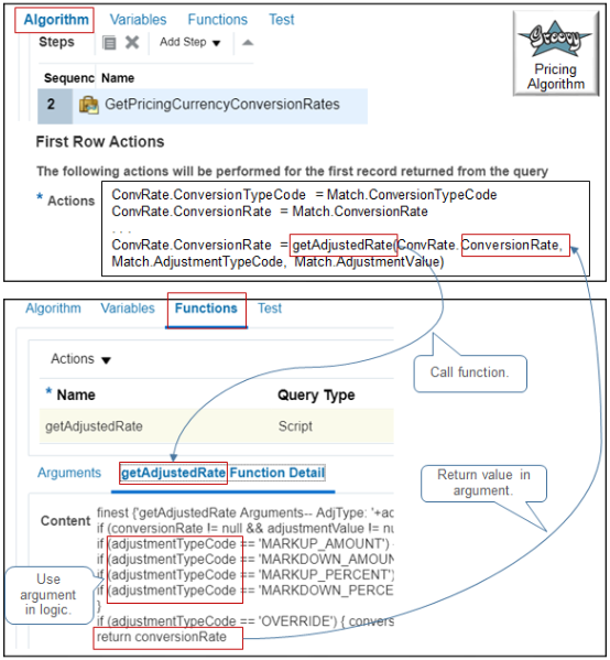

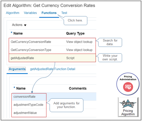

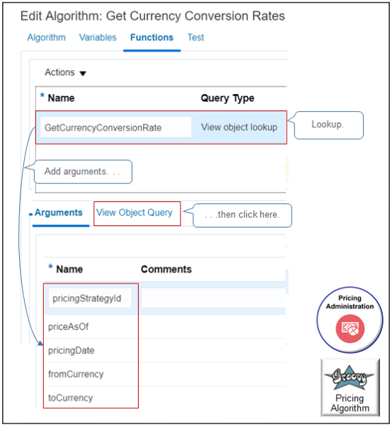

Functions
A function in a pricing algorithm is a routine that receives data from the pricing algorithm, processes it, then returns one or more values to the pricing algorithm. You can use a view object lookup function or a script function.
Here's an example of how the predefined Get Currency Conversion Rates algorithm uses two view object lookups, one script, and three arguments.
example of how the predefined Get Currency Conversion Rates algorithm uses two view object queries functions, one script function, and three arguments
Note
Attribute
Description
Name
Enter alphanumeric text. Use camel case and make the first letter lower case. Don't include spaces. For example, enter myPricingFunction.
Query Type
Choose a value.
  • View Object Lookup. Search for data in the Oracle database and return a result.
  • Script. Call a script that determines the value.
Argument
Click the Arguments link, then add arguments.
  • Use arguments to communicate data from the algorithm step to the function, and from the function to the step.
  • Enter the name.
    • Make sure its unique in the pricing algorithm across all functions.
    • Use camel case and make the first letter upper case.
    • Don't includes spaces.
    • For example, MyPricingFunctionArgument.
  • Sequence your arguments.
    Pricing uses the arguments you add in the same sequence you add them. For example, if you add argument x, and then y, and then z, then Pricing uses argument x first, and then y, and then z.
    Click Move Up or Move Down to modify the sequence.
  • You don't assign a data type to an argument. The argument takes the data type according to the value that the function sends through the argument. For example, if the function sends numeric data through argument x, then argument x is Numeric.
  • Use the Arguments tab to add arguments for a view object lookup or script.
Example of Script
A script runs procedural logic then returns values.
Here's an example of a step that uses script to call a function.
Note
  • Step 2, GetPricingCurrencyConversionRates, needs to get the currency conversion rate for the transaction.
  • Script in the First Row Actions section of GetPricingCurrencyConversionRates calls the getAdjustedRate function.
  • The function uses arguments, such as AdjustmentTypeCode and AdjustmentValue, to calculate the conversion rate.
  • The function returns the conversion rate in the ConversionRate argument.
Here's the complete script of the first row action. Notice how the script uses arguments frequently, such as ConversionRate, but makes only one call to the getAdjustedRate function. To improve performance, make only one call to the function in your script.
ConvRate.ConversionTypeCode = Match.ConversionTypeCode
ConvRate.ConversionRate = Match.ConversionRate
finest {'test GetCurrencyConversionRate - on First row'}
if (Match.ConversionTypeCode == 'GL_SOURCED') {
finest {'get GL Rate for -- FromCurr: '+FromCurrencyCode+' ToCurr: '+ToCurrencyCode+' PriceAsOf: '+PriceAsOf+' GlConvType: '+GlConversionTypeCode}
  rate = pricingUtil.getGlRate(FromCurrencyCode, ToCurrencyCode, PriceAsOf, GlConversionTypeCode)
finest {'GL Rate returned -- ConversionRate: '+rate}
ConvRate.ConversionRate = rate
finest {'ConversionRate: '+ConvRate.ConversionRate}
if (Match.AdjustmentTypeCode != null && ConvRate.ConversionRate != null && ((ConvRate.ConversionTypeCode.contains('GL') && ConvRate.ConversionRate != -1 && ConvRate.ConversionRate != -2) || !ConvRate.ConversionTypeCode.contains('GL'))) {
finest {'Rate Adjustment -- AdjType: '+Match.AdjustmentTypeCode+' AdjValue: '+Match.AdjustmentValue}
  ConvRate.ConversionRate = getAdjustedRate(ConvRate.ConversionRate, Match.AdjustmentTypeCode, Match.AdjustmentValue)
finest {'Conversion Error Check - ConvType: '+ConvRate?.ConversionTypeCode}
if (ConvRate?.ConversionTypeCode?.contains('GL') && (ConvRate.ConversionRate == null || ConvRate.ConversionRate == -1 || ConvRate.ConversionRate == -2)) {
finest {'GL Conversion Error'}
  ConvRate.ConversionRate = null;
  ConvRate.MessageTypeCode = 'ERROR';
  ConvRate.PrcMessageName = 'QP_PDP_PRICE_GL_CURR_ERROR';
  ConvRate.GlMessageName = (ConvPurpose == 'VALIDATE_PRICE')?'QP_PDP_POLICY_GL_CURR_ERROR':null;
  ConvRate.PrcErrorMessage = getFndMessage('QP','QP_PDP_PRICE_GL_CURR_ERROR', null);
  ConvRate.GlErrorMessage =  ((ConvPurpose == 'VALIDATE_PRICE')?getFndMessage('QP','QP_PDP_POLICY_GL_CURR_ERROR', null):null);
else if (!ConvRate?.ConversionTypeCode?.contains('GL') && (ConvRate.ConversionRate == null)) {
finest {'QP Conversion Error'}
  ConvRate.PrcMessageName = 'QP_PDP_PRICE_CURR_LIST_ERROR';
  ConvRate.GlMessageName = (ConvPurpose == 'VALIDATE_PRICE')?'QP_PDP_POLICY_CURR_LIST_ERROR':null;
  ConvRate.PrcErrorMessage = getFndMessage('QP','QP_PDP_PRICE_CURR_LIST_ERROR', null);
  ConvRate.GlErrorMessage =  (ConvPurpose == 'VALIDATE_PRICE')?getFndMessage('QP','QP_PDP_POLICY_CURR_LIST_ERROR', null):null;
Here's the complete script of the getAdjustedRate function. Use finest to declare your arguments, then add logic, such as If statements.
finest {'getAdjustedRate Arguments-- AdjType: '+adjustmentTypeCode+' AdjValue: '+adjustmentValue+' convRate: '+conversionRate}
if (conversionRate != null && adjustmentValue != null) {
if (adjustmentTypeCode == 'MARKUP_AMOUNT') { conversionRate += adjustmentValue}
if (adjustmentTypeCode == 'MARKDOWN_AMOUNT') { conversionRate -= adjustmentValue}
if (adjustmentTypeCode == 'MARKUP_PERCENT') { conversionRate += conversionRate * adjustmentValue / 100}
if (adjustmentTypeCode == 'MARKDOWN_PERCENT') { conversionRate -= conversionRate * adjustmentValue / 100}
if (adjustmentTypeCode == 'OVERRIDE') { conversionRate = adjustmentValue}
return conversionRate

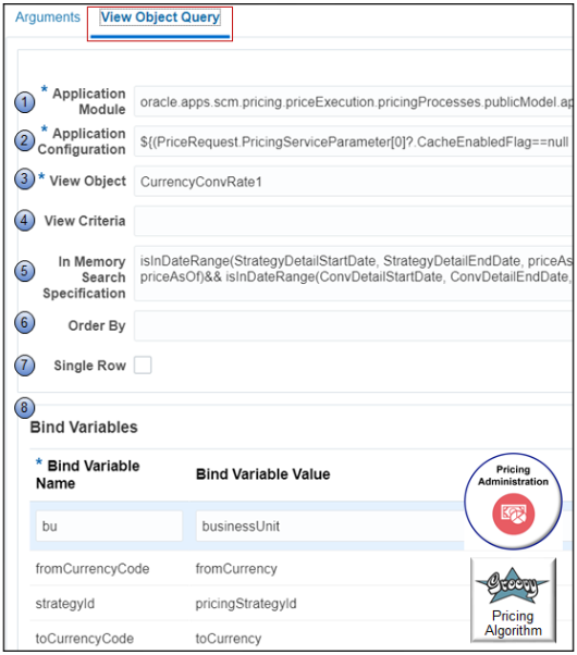

Example of View Object Lookup
Here's an example of a step that uses a view object lookup to call a function. To start, add your arguments.
Then click View Object Query, and set up the query. Here's a typical view object query. Note that view object query and view object lookup mean the same thing.
Here's the code that this example uses.
  1. Application Module.
    Example
    Description
    oracle.apps.scm.pricing.priceExecution.pricingProcesses.publicModel.applicationModule.PricingProcessAM
    Identify the application module.
    A pricing algorithm is part of the pricing process so use PricingProcess.
    • oracle.apps.scm.pricing.priceExecution. The path to PricingProcess.
    • applicationModule.PricingProcessAM. Specifies to use PricingProcessAM, where AM means application module.
    Learn about Application Module and Application Configuration. For details, see Choices That You Can Select in Pricing Matrixes.
  2. Application Configuration.
    Example
    Description
    ${(PriceRequest.PricingServiceParameter[0]?.CacheEnabledFlag==null || PriceRequest.PricingServiceParameter[0].CacheEnabledFlag) ? 'PricingProcessAMShared' : 'PricingProcessAMLocal'}
    You must use this configuration for most algorithms.
  3. View Object.
    Example
    Description
    CurrencyConvRate1
    Enter the name of the view object.
    Pricing comes predefined to use CurrencyConvRate1 for the GetCurrencyConversionRate function.
    You can also use the fully qualified name. Here's an example that identifies the name of the view object when you use a descriptive flexfield.
    oracle.apps.flex.scm.pricing.priceExecution.pricingProcesses.priceListCharges.view.PriceListChargeDFFVO
    where
    • oracle.apps.flex.scm.pricing.priceExecution.pricingProcesses.priceListCharges. The path to the priceListCharges entity of the pricingProcesses application module for flexfields.
    • PriceListChargeDFFVO. Name of the view object, where DFFVO means descriptive flexfield view object.
  4. View Criteria.
    Example
    Description
    No value for this example.
    Criteria that determines whether you can query the view object according to the bind variables.
  5. In Memory Search Specification.
    Example
    Description
    isInDateRange(StrategyDetailStartDate, StrategyDetailEndDate, priceAsOf) && isInDateRange(ConvListStartDate, ConvListEndDate, priceAsOf)&& isInDateRange(ConvDetailStartDate, ConvDetailEndDate, pricingDate)
    Add search specifications that filter results of the view object that's currently in memory.
    This example includes three isInDateRange functions that specify how to search.
    The first isInDateRange filters according to pricing strategies.
    • isInDateRange. Name of the search specification.
    • StrategyDetailStartDate. Filter results so they only include pricing strategies that start on or after this date.
    • StrategyDetailEndDate. Filter results so they only include pricing strategies that start on or before this date.
    • priceAsOf. Filter results so they only include records where Pricing used the strategy to price an item on a specific date.
    The second isInDateRange filters according to currency conversion lists.
    • ConvListStartDate. Filter results so they only include currency conversion lists that start on or after this date.
    • ConvListEndDate. Filter results so they only include currency conversion lists that end on or before this date.
    • priceAsOf. Filter results so they only include records where Pricing used the conversion list to price an item on a specific date.
    The third isInDateRange filters according to currency conversion details.
    • ConvDetailStartDate. Filter results so they only include currency conversion details that start on or after this date.
    • ConvDetailEndDate. Filter results so they only include currency conversion details that end on or before this date.
    • pricingDate. Filter results so they only include records where Pricing used the conversion details to price an item on a specific date.
    The specifications are cumulative. For example, this specification filters according to pricing strategy, and currency conversion list, and conversion detail.
    Assume the search specifications filter to return only pricing strategies a and b, currency conversion lists c and d, and conversion detail e. If records 1, 2, and 3 include pricing strategies a and b, and if records 7 and 8 include currency conversion lists c and d, and if record 9 includes conversion details e, then the search results will include records 1, 2, 3, 7, 8, and 9.
  6. Order By.
    Example
    Description
    Sort the records of the data set in ascending order or descending order, according to one or more columns.
    For example, to use precedence when sequencing the query results according to prices on the pricing strategy, set Order By to Precedence.
    Order By affects performance. Don't use it unless you really need it.
    For details, see the Data Sets section of this topic.
  7. Single Row.
    Example
    Description
    Disabled for this example.
    Check whether the view object can return only one row. For example, a price list includes only one Price List Id. If you query according to Price List Id, then enable Single Row.
    Enabling this option decreases processing time because the algorithm proceeds immediately after it receives the one record instead of searching through all possible records.
  8. Bind Variables.
    Example
    Description
    Bind Variable Name. For example, fromCurrencyCode.
    Name of the bind variable that you add to the view object.
    Bind Variable Value. For example, fromCurrency.
    Use a fixed value, Groovy expression, or argument name. In this example, fromCurrency is the name of argument for this function.
If you add a lookup for a hierarchical view object, then you can click the Hierarchical Query tab, then set properties.
Properties
Description
Connect By
Specify how to connect.
Query Result Alias
Specify the alias.
