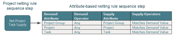

Net project task supply |
Net a supply whose project and task attributions exactly matches the demand attributions. In the netting sequence step of the attribute-based netting rule, for the Project, Project Group, and Task attributes, select:
The configuration of the netting sequence step ensures the planning process nets supplies whose project group, project, and task match the project group, project, and task attribute’s values of the demand in a netting window. |

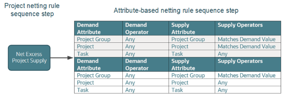

Net excess project supply |
When the reservation level is Project, use supplies from any tasks of the same project for project demands. When the reservation level is Project Group, use supplies from any tasks or any projects of the same project group for demands across any project in the same project group. The configuration in the attribute-based netting rule consists of two netting sequence steps. In the first netting sequence step, select:
This configuration of netting sequence steps ensures the planning process nets supplies whose project and project group match the project and project group attribute’s values of the demand in a netting window. In the second netting sequence step, select:
This configuration of the netting sequence step ensures the planning process nets supplies whose project group matches the project group attributes values of the demand in a netting window. The two netting sequence steps in the attribute-based netting rule are similar to netting excess project supplies within a project, tasks, and projects within a project group when the reservation level in the project netting rule is set to the project group. |

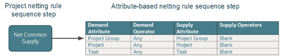

Net common supply |
Net a supply that doesn't have any project or task attribution. It can be an on-hand supply, purchase order supply, work order supply, and so on. Such supplies can be used for any project, any task, or any common demand. In the netting sequence step of the attribute-based netting rule, for the Project, Project Group, and Task attributes, select:
This configuration of netting sequence steps ensures that the planning process nets common supplies project demands in a netting window. |
