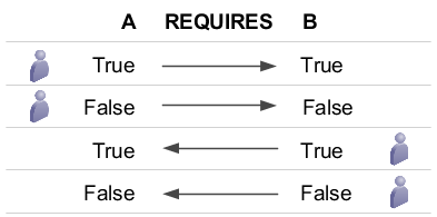

Requires
If you select an option, then Oracle Configurator applies the same value to the other option.
If you:
- Select option a, then Configurator also selects option b.
- Deselect option a, then Configurator also deselects option b.
- Select option b, then Configurator also selects option a.
- Deselect option b, then Configurator also deselects option a.

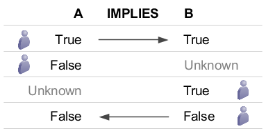

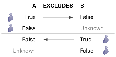

Implies
Here's how an Implies rule works.
If you:
- Deselect option a, then Configurator deselects option b, and you can select or deselect option b.
- Select option b, then Configurator deselects option a, and you can select or deselect option a.
