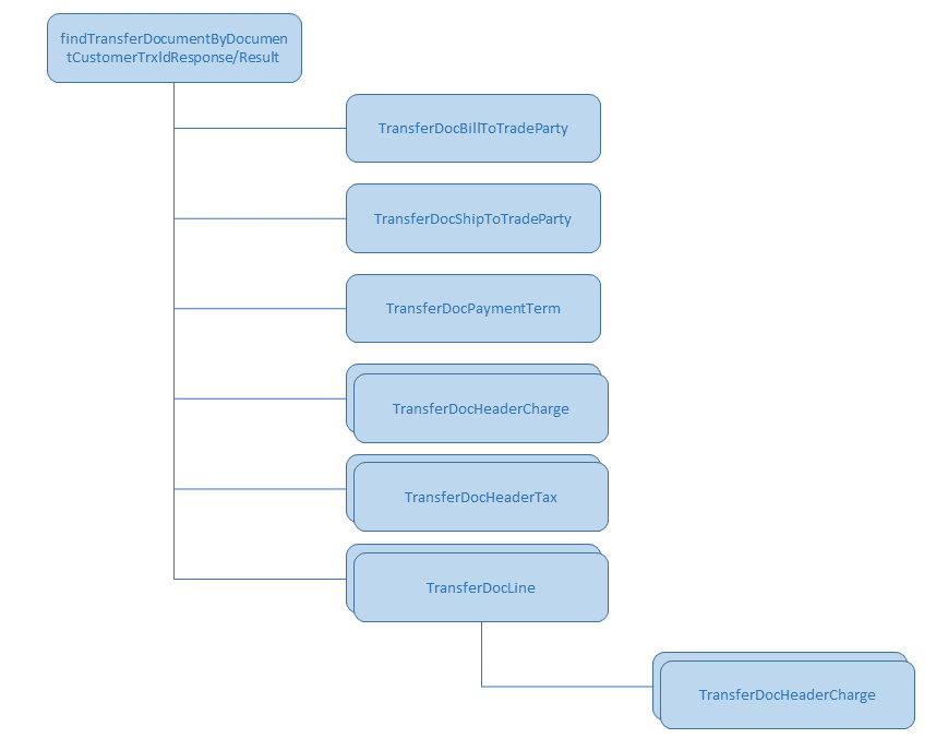

Data Mapping
The below figure shows the structure of the payload that's received from the application for the UBL-2.1-PEPPOL-Invoice-Out-V2 message.
Refer to Figure 2 in UBL-2.1-PEPPOL-Invoice-Out for the structure of the payload that's sent to the customer.
DocumentTransferService | UBL-2.1-PEPPOL-Invoice-Out-V2 |

AddressLineOne | DeliveryLocation/Address/AddressLine/Line |
CountryCode | DeliveryLocation/Address/Country/IdentificationCode
There is a predefined DVM, COUNTRY_CODE in use for this field. |
PartyName | DeliveryParty/PartyName/Name |
TransferDocHeaderCharge | AllowanceCharge |
ChargeIndicator This is set to true. |
LineType | AllowanceChargeReasonCode There is a predefined DVM, CHANGE_REASON_CODE in use for this field. |
LineType | AllowanceChargeReason |
result/CurrencyCode | Amount/@currencyID There is a predefined DVM, CURRENCY_CODE in use for this field. |
ChargeAmount |
Amount |
TaxCategory/ID This is set to E. |
TaxCategory/Percent This is set to 0. |
TaxCategory/TaxScheme/ID This is set to VAT. |
TransferDocLine |
InvoiceLine If DocumentType is 'CM' and $passCreditNote "true()", then the element is CreditNoteLine. Otherwise, the element is InvoiceLine. |
TransferDocLine/TransferDocLineCharge |
AllowanceCharge
LineType | AllowanceChargeReasonCode There is a predefined DVM, CHARGE_REASON_CODE in use for this field. |
sum(TransferDocLineCharge[LineType =
$current]/ChargeAmount) |
Amount |
result/CurrencyCode | TaxTotal/TaxAmount/@currencyID There is a predefined DVM, CURRENCY_CODE in use for this field. |
TotalTaxAmount | TaxTotal/TaxAmount |
TaxTotal/TaxSubtotal/ Set to
result/CurrencyCode | TaxableAmount/@currencyID There is a predefined DVM, CURRENCY_CODE in use for this field. |
totalChargeAmount +
totalTaxExemptTaxableAmount |
TaxableAmount
result/CurrencyCode | TaxAmount/@currencyID There is a predefined DVM, CURRENCY_CODE in use for this field. |
TaxAmount This is set to 0. |
TaxCategory/TaxExemptionReason This is set to Exempt. |
TransferDocHeaderTax | TaxTotal/TaxSubtotal TransferDocHeaderTax is mapped if TaxRateCode it is not exempt. |
TaxableAmount | TaxableAmount |
TaxAmount | TaxAmount |
TaxRateCode | TaxCategory/ID There is a predefined DVM, TAX_CATEGORY_CODE in use for this field. |
TaxRate | TaxCategory/Percent If no value is provided, this is set to 0. |
ExemptReasonCode | TaxCategory/TaxExemptionReasonCode |
ExemptReason | TaxCategory/TaxExemptionReason If no value is provided, this is set to Exempt. |
result/CurrencyCode | LegalMonetaryTotal/LineExtensionAmount/@currencyID There is a predefined DVM, CURRENCY_CODE in use for this field. |
LineExtensionAmount | LegalMonetaryTotal/LineExtensionAmount |
CurrencyCode | LegalMonetaryTotal/TaxExclusiveAmount/@currencyID There is a predefined DVM, CURRENCY_CODE in use for this field. |
TaxExclusiveAmount | LegalMonetaryTotal/TaxExclusiveAmount |
CurrencyCode | LegalMonetaryTotal/TaxInclusiveAmount/@currencyID There is a predefined DVM, CURRENCY_CODE in use for this field. |
InvoiceAmount | LegalMonetaryTotal/TaxInclusiveAmount |
CurrencyCode | LegalMonetaryTotal/AllowanceTotalAmount/@currencyID There is a predefined DVM, CURRENCY_CODE in use for this field. |
sum(tns:TransferDocPaymentTerm[tns:DiscountAmount !=
'']/tns:DiscountAmount) |
LegalMonetaryTotal/AllowanceTotalAmount The sum of
CurrencyCode | LegalMonetaryTotal/ChargeTotalAmount/@currencyID
sum(TransferDocHeaderCharge[ChargeAmount !=
'']/ChargeAmount) or
sum(TransferDocLine[TransferDocLineCharge]/TransferDocLineCharge[LineType
!= '']/ChargeAmount) |
LegalMonetaryTotal/ChargeTotalAmount The sum of
CurrencyCode | LegalMonetaryTotal/PrepaidAmount/@currencyID If the LegalEntityCountryCode is France (FR), then map CurrencyCode. There is a predefined DVM, CURRENCY_CODE in use for this field. |
PrepaymentAmount | LegalMonetaryTotal/PrepaidAmount If the LegalEntityCountryCode is France (FR), then map PrepaymentAmount. |
CurrencyCode | LegalMonetaryTotal/PayableRoundingAmount/@currencyID If the LegalEntityCountryCode is France (FR), then map CurrencyCode. There is a predefined DVM, CURRENCY_CODE in use for this field. |
OrderRoundingAmount InvoiceAmount | LegalMonetaryTotal/PayableRoundingAmount If the LegalEntityCountryCode is France (FR), then map OrderRoundingAmount otherwise map InvoiceAmount. |
CurrencyCode | LegalMonetaryTotal/PayableAmount/@currencyID |
InvoiceAmount | LegalMonetaryTotal/PayableAmount |
TransferDocLine |
InvoiceLine if DocumentType is 'CM' and $passCreditNote "true()" then the element is CreditNoteLine. Otherwise, the element is InvoiceLine. |
LineNumber | ID |
Description | Note |
UnitOfMeasure |
InvoicedQuantity/@unitCode If DocumentType is 'CM' and $passCreditNote "true()" then the element is CreditedQuantity. Otherwise, the element is InvoicedQuantity. There is a predefined DVM, UOM_CODE in use for this field. |
Quantity |
InvoicedQuantity If DocumentType is 'CM' and $passCreditNote "true()" then the element is CreditedQuantity. Otherwise, the element is InvoicedQuantity. |
LineAmount | LineExtensionAmount |
TransferDocSalesOrder[1]/SalesOrderLine |
OrderLineReference/LineID If the LegalEntityCountryCode is not
TransferDocSalesOrder/SalesOrderLine |
OrderLineReference/SalesOrderLineID If the
TransferDocSalesOrder/SalesOrder | OrderLineReference/OrderReference/ID If the
ShipToLocAddress1 | Delivery/DeliveryLocation/Address/StreetName
If the LegalEntityCountryCode is France (FR), then ShipToLocAddress1 is mapped. |
ShipToLocAddress2 | Delivery/DeliveryLocation/Address/AdditionalStreetName
If the LegalEntityCountryCode is France (FR), then ShipToLocAddress2 is mapped. |
ShipToLocAddress3 | Delivery/DeliveryLocation/Address/AddressLine/Line If the LegalEntityCountryCode is France (FR), then ShipToLocAddress3 is mapped. |
ShipToLocCity | Delivery/DeliveryLocation/Address/CityName
If the LegalEntityCountryCode is France (FR), then ShipToLocCity is mapped. |
ShipToLocPostalCode | Delivery/DeliveryLocation/Address/PostalZone If the LegalEntityCountryCode is France (FR), then ShipToLocPostalCode is mapped. |
ShipToLocCounty | Delivery/DeliveryLocation/Address/CountrySubentity
If the LegalEntityCountryCode is France (FR), then ShipToLocCounty is mapped. |
ShipToLocCountry | Delivery/DeliveryLocation/Address/Country/IdentificationCode
If the LegalEntityCountryCode is France (FR), then ShipToLocCountry is mapped. |
InvoiceLine/AllowanceCharge If DocumentType is 'CM' and $passCreditNote "true()" then the element is CreditNoteLine. Otherwise, the element is InvoiceLine. |
LineType |
ChargeAmount |
Amount |
ItemDescription | Item/Description |
TranslatedDescription | Item/Name Set to Item Name. |
TpItemDesc | Item/BuyersItemIdentification/ID |
ItemNumber | Item/SellersItemIdentification/ID |
ItemCategoryName | CommodityClassification/ItemClassificationCode |
TransferDocLine/TransferDocTax |
InvoiceLine/Item/ClassifiedTaxCategory If DocumentType is 'CM' and $passCreditNote "true()" then the element is CreditNoteLine. Otherwise, the element is InvoiceLine. |
TaxRateCode | ID There is a predefined DVM, TAX_CATEGORY_CODE in use for this field. |
TaxRate | Percent |
result/CurrencyCode | Price/PriceAmount/currencyID There is a predefined DVM, CURRENCY_CODE in use for this field. |
UnitSellingPrice | Price/PriceAmount |

<ns1:TransferDocHeaderCharge>
<ns1:ChargeAmount currencyCode="USD">10000</ns1:ChargeAmount>
<ns1:LineType>FREIGHT</ns1:LineType>
<!-- CHARGE_REASON_CODE -->
</ns1:TransferDocHeaderCharge>
<ns1:TransferDocLineCharge>
<ns1:ChargeAmount>5.00</ns1:ChargeAmount>
<ns1:LineType>MISC</ns1:LineType>
</ns1:TransferDocLineCharge>
<ns1:TransferDocLine>
<ns1:LineType>LINE</ns1:LineType>
<ns1:LineNumber>1</ns1:LineNumber>
<ns1:LineAmount currencyCode="USD">100000</ns1:LineAmount>
<ns1:CurrencyCode>EUR</ns1:CurrencyCode>
<ns1:UnitSellingPrice currencyCode="USD">500</ns1:UnitSellingPrice>
<ns1:Quantity unitCode="Ea">200</ns1:Quantity>
<ns1:Description>Sentinel Personal</ns1:Description>
<ns1:UnitOfMeasure>Ea</ns1:UnitOfMeasure>
<!-- UOM_CODE -->
<ns1:Item>PTO54222</ns1:Item>
<ns1:ItemDescription>Sentinel Personal</ns1:ItemDescription>
<ns1:ReferenceNumber>:683158:1233895</ns1:ReferenceNumber>
<ns1:TaxPointDate>2015-12-14</ns1:TaxPointDate>
<ns1:LineTaxAmount currencyCode="USD">20000</ns1:LineTaxAmount>
<ns1:RoundedLineTaxAmount currencyCode="USD">0</ns1:RoundedLineTaxAmount>
<ns1:TaxClassificationCode>VAT20</ns1:TaxClassificationCode>
<ns1:TrxBusinessCategory>SALES_TRANSACTION</ns1:TrxBusinessCategory>
<ns1:ProductType>GOODS</ns1:ProductType>
<ns1:UserDefinedFiscClass xsi:nil="true"/>
<ns1:ItemNumber>PTO54222</ns1:ItemNumber>
<ns1:TranslatedDescription xsi:nil="true"/>
<ns1:TpItemNumber xsi:nil="true"/>
<ns1:TpItemDesc xsi:nil="true"/>
<ns1:ItemCategoryName>Uncategorized</ns1:ItemCategoryName>
<ns1:TaxClassificationMeaning>VAT20</ns1:TaxClassificationMeaning>
<ns1:TrxBusinessCategoryName>Sales Transaction</ns1:TrxBusinessCategoryName>
<ns1:ProductFiscClassifCode xsi:nil="true"/>
<ns1:ProductFiscClassifDesc xsi:nil="true"/>
<ns1:LineIntendedUseCode xsi:nil="true"/>
<ns1:LineIntendedUseDesc xsi:nil="true"/>
<ns1:ProductCategoryName xsi:nil="true"/>
<ns1:ProductCategoryCode xsi:nil="true"/>
<ns1:UserDefinedFiscClassName xsi:nil="true"/>
<ns1:ItemDescriptionUs>Sentinel Personal</ns1:ItemDescriptionUs>
<ns1:OriginalTrxNumber>12345</ns1:OriginalTrxNumber>
<ns1:OriginalTrxType>Invoice</ns1:OriginalTrxType>
<ns1:OriginalTrxClass>INV</ns1:OriginalTrxClass>
<ns1:OriginalTrxDate>14-DEC-15</ns1:OriginalTrxDate>
<ns1:OriginalLineNumber>1</ns1:OriginalLineNumber>
<ns1:ShipToLocAddress1>320 N First St</ns1:ShipToLocAddress1>
<ns1:ShipToLocAddress2>1</ns1:ShipToLocAddress2>
<ns1:ShipToLocAddress3>2</ns1:ShipToLocAddress3>
<ns1:ShipToLocCity>San Jose</ns1:ShipToLocCity>
<ns1:ShipToLocPostalCode>95113</ns1:ShipToLocPostalCode>
<ns1:ShipToLocCounty>Santa Clara</ns1:ShipToLocCounty>
<ns1:ShipToLocCountry>US</ns1:ShipToLocCountry>
<ns1:TransferDocSalesOrder>
<ns1:CustomerTrxLineId>1233895</ns1:CustomerTrxLineId>
<ns1:SalesOrder>404082</ns1:SalesOrder>
<ns1:SalesOrderRevision xsi:nil="true"/>
<ns1:SalesOrderDate>2015-12-14</ns1:SalesOrderDate>
<ns1:SalesOrderLine>300100088483495</ns1:SalesOrderLine>
</ns1:TransferDocSalesOrder>
<ns1:ChargeAmount>10.00</ns1:ChargeAmount>
<!-- End -->
<ns1:TransferDocPurchaseOrder>
<ns1:PurchaseOrder>PO123456789</ns1:PurchaseOrder>
</ns1:TransferDocPurchaseOrder>
<ns1:TransferDocTax>
<ns1:TaxAmount currencyCode="USD">20000</ns1:TaxAmount>
<ns1:CurrencyCode>USD</ns1:CurrencyCode>
<ns1:TaxCode>VAT20</ns1:TaxCode>
<ns1:TaxRate>20</ns1:TaxRate>
<ns1:TaxRateCode>S</ns1:TaxRateCode>
<!-- TAX_CATEGORY_CODE -->
</ns1:TransferDocTax>
</ns1:TransferDocLine>
