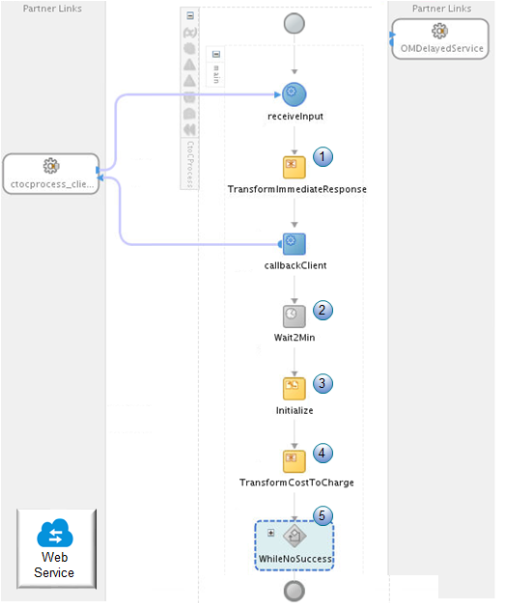

Add a new step in your orchestration process that references your new task. Place it after the step that completes the shipment task and before the step that starts the invoice task. The published payload for your task will contain the shipping cost that you capture in the shipping system.
Set up your connector. Here's what it looks like in Oracle's Java Developer.
Note

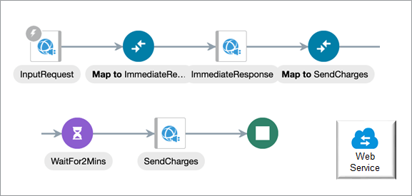

Transform your input into an immediate response and send it to Order Management.
Wait for two minutes.
Initialize local variables, such as Result and Counter.
Transform your input into a delayed response. It converts cost to charge, including a mark up, if necessary.
Send a delayed response, then wait for a SUCCESS reply.
Make sure you also implement error handling to handle an ERROR reply.

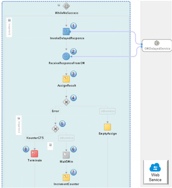

Here's an expanded view of step 5, WhileNoSuccess.
Send the delayed response that contains charges back to Order Management. The diagram doesn't include this step.
The connector updates these charges in Order Management, then sends them to invoicing.
Note
Send charges in a delayed response to Order Management.
Receive a reply from Order Management. The reply contains SUCCESS or ERROR.
Save the results of the reply in a local variable.
This is the If condition that routes the flow depending on the value of the local variable, SUCCESS or ERROR.
This is the If condition that routes the flow depending on the Counter local variable that counts the number of attempts.
Depending on the error that you receive, wait five minutes, then call the service in Order Management again.
Increment the Counter variable.
If Counter is equal to or greater than 5, then end the flow.
You can modify the value in Counter to meet your needs.
